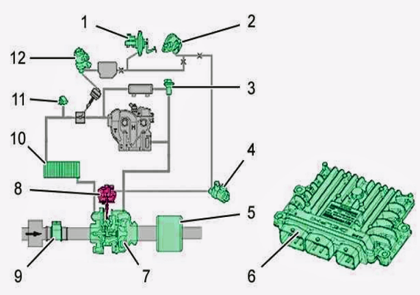

Just as an update to this thread, stumbling across this diagram Marc posted about the fuel / air system on the Siemens operated DW10B the Doseur is called the "Throttle Butterfly Housing (EGR)". Therefore I can conclude that the Air Doseur is indeed used to assist the EGR system.
Diagram here, Siemens system, note points 1 and 21:

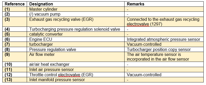

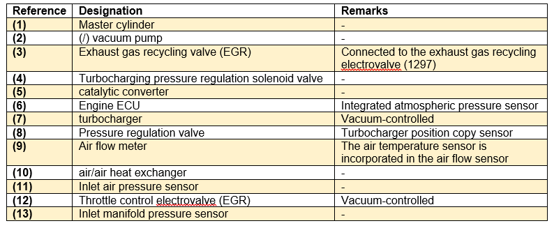

Similarly for the Delphi injection system, point 12:
GiveMeABreak wrote: 17 Aug 2018, 02:16 EGR Circuit C5 X7 DW10BTED4 FAP with Delphi 3.4 Injection
