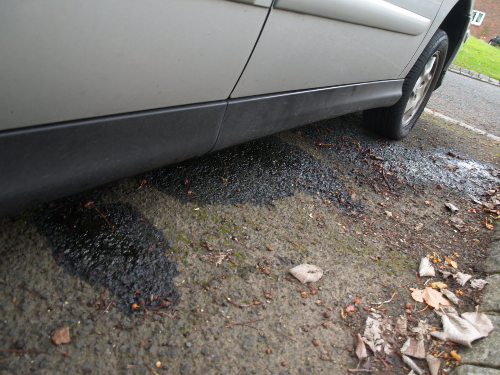

Swapped batteries this morning to charge the one in the car as voltage was reduced due to the pump trying to lift the car and failing.
Charging the 'proper' one now.
While swapping the batteries it became clear where the leak was coming from, somewhere behind the engine on the offside, near the pump/reservoir. The pump tried to raise the car when I opened the door and started the engine to open the window.
It is also running down the sill and dripping off near the rear door.
When I had swapped batteries and went out to reset the BSI and lock the car it had raised to full height and was dripping away merrily.
It has now sunk back down at the rear.

Re: C5 suspension grump
That dripping to the rear could be as a result of it being higher at the front and running down periodically Steve. It definitely seems concentrated near and around the BHI. Once your mech. gets that wheel arch opened he'll no doubt be able to trace the source of the leak.

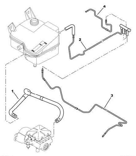

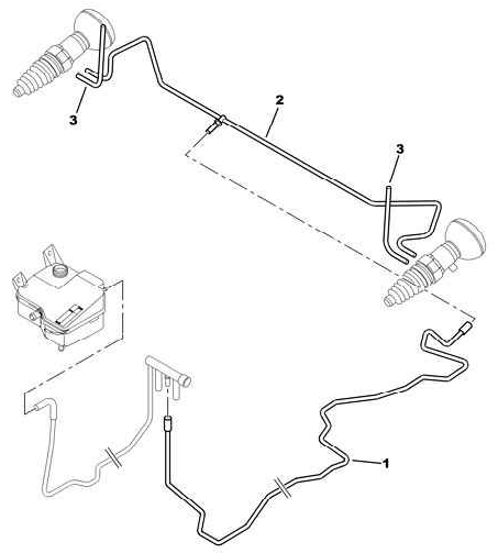

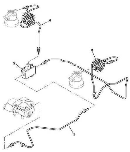

Thought this might be helpful:
C5 I Supply Piping Rear
C5 I Supply Piping Front
C5 I Return Piping Rear
C5 I Return Piping Front
Thanks Marc!
I am presuming a breach in pipe #1, image #2.
