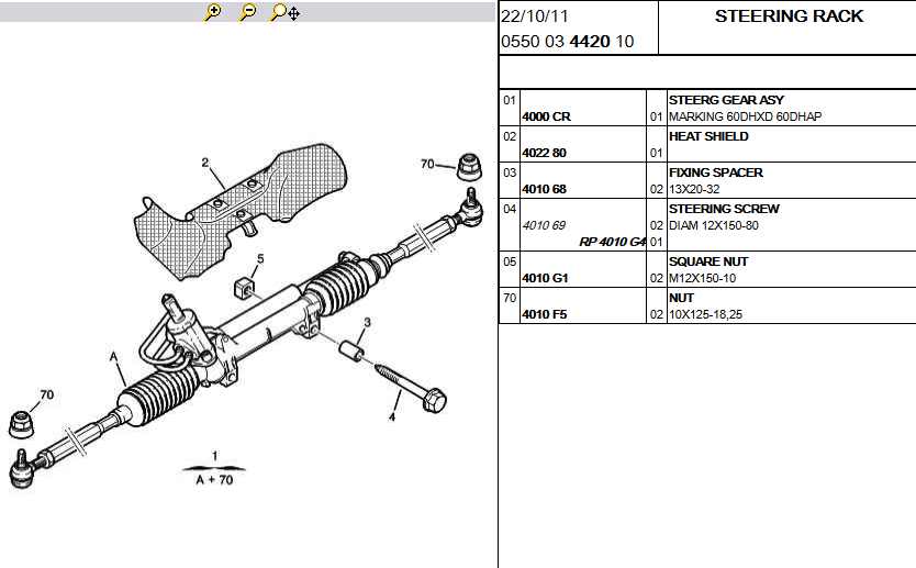

Bobins, can you look up the on for the rack?
