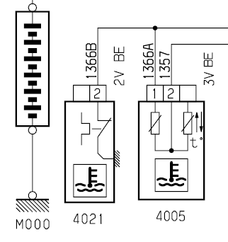

Temp sensor replaced all appears fine. However one question. This is the 3 pin connector however when disconnecting the connector I noticed there are only 2 wires the third wire a green one looks like its been cut at the connector but cant see the other end on the harness as the sensor works ive got power and signal so assume its an earth If so why cut it
- x 6957
Re: Temp sensor
Hang on I'll just re-check the circuit diagram - ok, so nothing to worry about - parts said the 3-pin, but diagram shows just 2 connections:
See 4005 - as you can see 1357 is the earth and 1366A is the engine coolant temperature signal.
It's possible they use the same harness for different engines and chop off the additional wire at the plug where not needed to avoid confusion (not!)
You have the right one.
