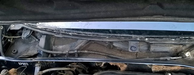

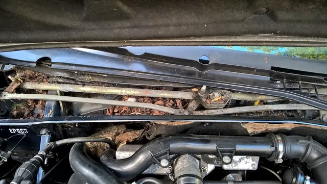

Ah well, best laid plans and all that! Got the dash out eventually (seriously folks how many bolts do you need to hold the bloody thing in?), would have been a lot quicker but for trying to separate an original windscreen from an original, and very brittle, scuttle panel with, of course, the most amount of mastic you've seen on one of these things. Took me an hour to separate them, to be met with this

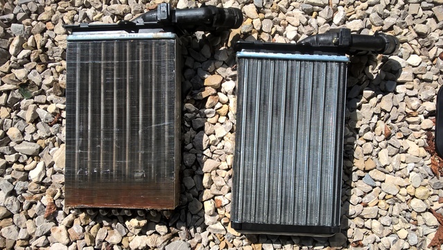

With the aid of a paint brush it became this

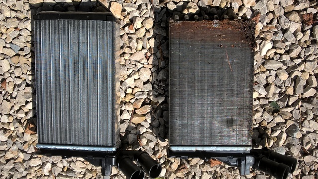

Matrix coupling came off very easy but the heater box did not want to separate. Just what I didn't want after the windscreen scuttle. And then out with the old, in with the new

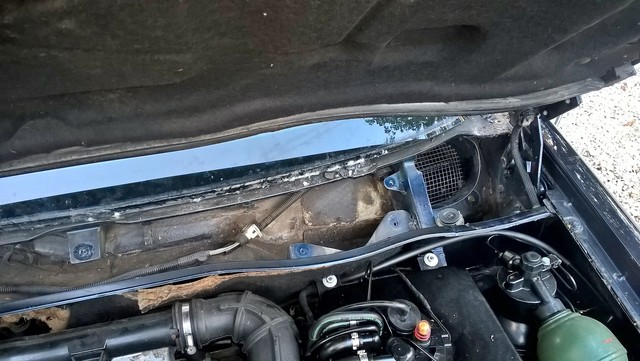

Once the heater box was back together I unscrewed the bleed nipples, put the upturned bottle on the expansion tank, and poured fresh water in until the rust coloured water became clear. And no leaks!

Well done Eddie that matrix doesn't look too clever.

Good work indeed :D Excellent!
That old matrix was well past it's best... No wonder it was a bit incontinent....

I does prove why "RadSeal" products do not always work :)

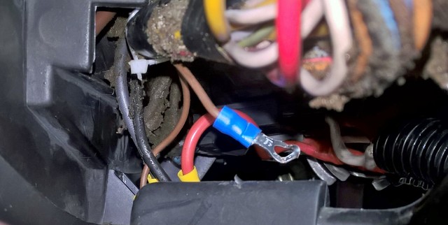

Thinking about the small part I have left to do :roll: and three things come to mind. There's a green connector to the right of the steering column that on my pictures passes through the hole left after I removed the blanking plate. Any ideas if this is actually for something?

I'm back :P What's the blue wire for? It's located to the left of the steering column and is attached to the connectors for the indicators, but although it looks like an earth there is nothing for it to connect to.

At a guess the yellow sleved connectors just below it are going to a relay for the blower relay mod, and the connector in question is the earth for the relay coil.
