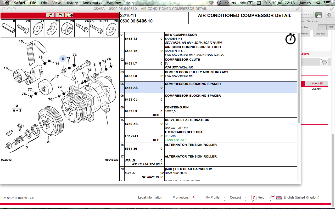

I can't find exactly what I was looking for but it looks like your car has a 1744 belt and a Sanden int compressor as standard.

I checked the AC compressor. Its definitely the Sanden unit that is in the diagram that was posted by elma.
