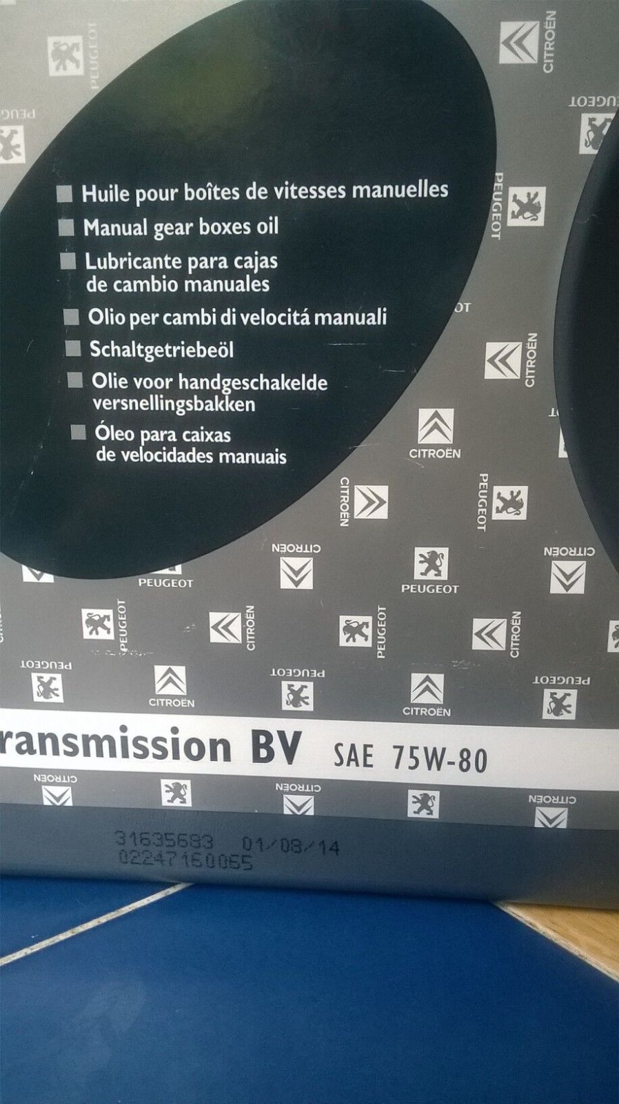

I don't know how to add a photo and as I said earlier I can't get oil through the post because of the supposed flash point.
This is the oil says 9730.A2 on the can and as itr came from a Citroen garage and has loads of little citroen and Peugeot logos I'm pretty sure it's the correct oil.

9730.A2 is the CIt/Peu part number for the oil you need, and packaged accordingly.
