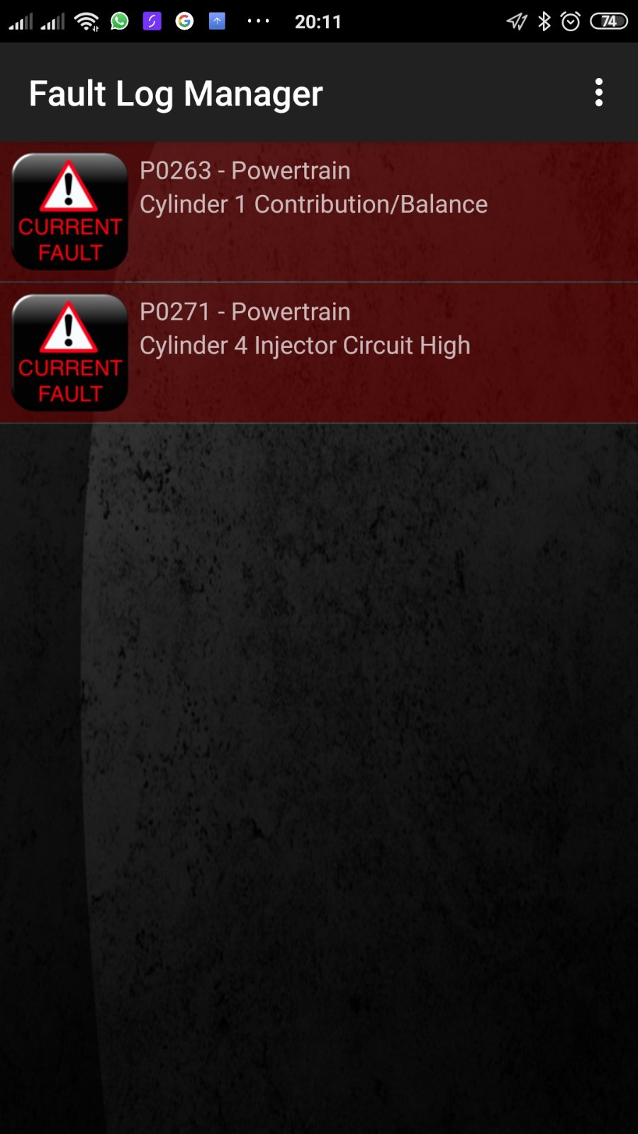

I'll get the VIN in the morning but for now, see the attached screenshot of the faults Torque reported. I do have Lexia too but didn't use it on this occasion so don't have the proper Citroen fault codes if they're different..?

So that's :
P0263 - Cylinder 1 Contribution/Balance
P0271 - Cylinder 4 Injector Circuit High

Ok, so the first thing I noticed when checking is that there is a recall notification for your specific vehicle:
An after-sales campaign must be carried out on this vehicle. Advise your client to make an appointment with their authorised dealer as soon as possible
When I ran the fault codes which I'll summarise below, it would seem that there is a technical service bulletin concerning where these 2 specific fault codes are present. I think the technical bulletin with reference (B1HW0175Q0) concerns issues to do with the injectors and that it involved Citroen replacing some of the injectors and/ or injection components. Now I don't have access to the details or the specifics, but researching it seems the content of one of these technical bulletins concerns the following that may be relevant (and I've had to translate this from German in case the grammar isn't quite correct). Note there is an almost identical one where the fault code is P0271 with P0263 - this one below realtes to the P0272 TSB - but the reference I have provided (B1HW0175Q0) relates to your 2 codes. I've just quoted listed the detail relating the the TSB with the P0272 fault - as I believe it is a similar issue).
COMPLAINT: Combustion noise - If the DTC or DTCs P0263, P0266, P0269, P0272 are present
CAUSE:
Noise reduction and correction of injectors out of tolerance.
CUSTOMER SERVICE INTERVENTION:
Query the error codes.
Replacing the diesel injector (s).
Replacing the noise insulation of the diesel injectors.
Required parts
Diesel injectors (part number depending on vehicle definition) (quantity depending on the result of the inspection).
Centering rings (part number depending on vehicle definition) (quantity depending on the result of the inspection).
Gasket Diesel injector (part number depending on vehicle definition) (quantity depending on the result of the check).
Fork support pins (part number depending on vehicle definition) (quantity depending on the result of the inspection).
Flanges of diesel injectors (part number depending on vehicle definition) (quantity depending on the result of the check).
Screw the flanges of the diesel injectors (part number depending on the vehicle definition) (quantity depending on the result of the inspection).
High-pressure fuel lines (part number depending on the vehicle definition) (quantity depending on the result of the inspection).
1 noise insulation (ET number 1982H2).
1 strand fuel return lines (part number depending on vehicle definition).
So I'm wondering if this recall is to do with the above.
As this is expensive I believe that depending on the year and the mileage (Vehicle may not be older than 84 months and under 140,000 km) they may offer partial funding of the repairs - either the labour cost where you pay the parts or the full amount or some gesture of goodwill - it will all depend on the maintenance and other factors as mentioned.
So I think your best bet is to contact your dealer directly and tell them you have been advised of the recall and that you are getting the 2 fault codes for which you understand there is a TSB (Technical Service Bulletin) for and quote the reference I provided earlier.
As for the faults which are related to the TSB:
P0271: Injector 4 signal: Short circuit to positive on the circuit (harness, injector, ECU). Electrical fault. Short circuit between the 2 tracks detected for 400 ms when injector 4 is controlled,
Down Grade Modes:
  • Closing of the ECU valve
  • Irreversible deactivation of the vehicle speed limiter
  • Irreversible deactivation of the vehicle cruise control
  • Inhibiting of the exhaust heat recovery function
  • Prohibiting of regeneration of the particle emission filter and stopping of the requests in progress
  • Inhibiting of the injectors reset strategy
  • Cutting of fuel injector 4
  • Switching to fuel "normal reduced flow" mode
  • Deactivation of the request for regeneration of the particle filter from the diagnostic tool
Customer Symptoms:
  • Jerking/stalling
  • Engine acceleration at wrong time
  • Noise
  • Slightly higher fuel consumption
  • Starting problem
  • Smoke from the exhaust
  • Lack of power
Suspect Areas:
  • Fuel injector 4
  • Electrical harness
  • Connectors
P0263: No. 1 cylinder: Injector resetting outside tolerance. Difference of more than 0.8 mg/stroke between the pilot injection and the flow reference value.
Downgrade Modes:
  • Reversible deactivation of the vehicle speed limiter
  • Reversible deactivation of the vehicle cruise control
Customer Symptoms:
  • Jerking/stalling
  • Noise
  • Starting problem
  • Lack of power
Suspect Areas:
  • Fuel injector 1
  • Injector classification
  • Poor quality of the fuel or type of fuel
  • Fuel return
  • Inlet valve - Exhaust valve - Spring - Seal
  • Piston - Piston rings - Shaft - Cooling system
  • Conrods
So not a simple one this and I really think your first port of call is the dealer to see what if anything they will do under a goodwill gesture.
Given your vehicle's age I would get on the phone straight away and if you don't get any satisfaction, ring Citroen Head Office direct and complain about it - it does often make a difference if a dealer doesn't want to know.
