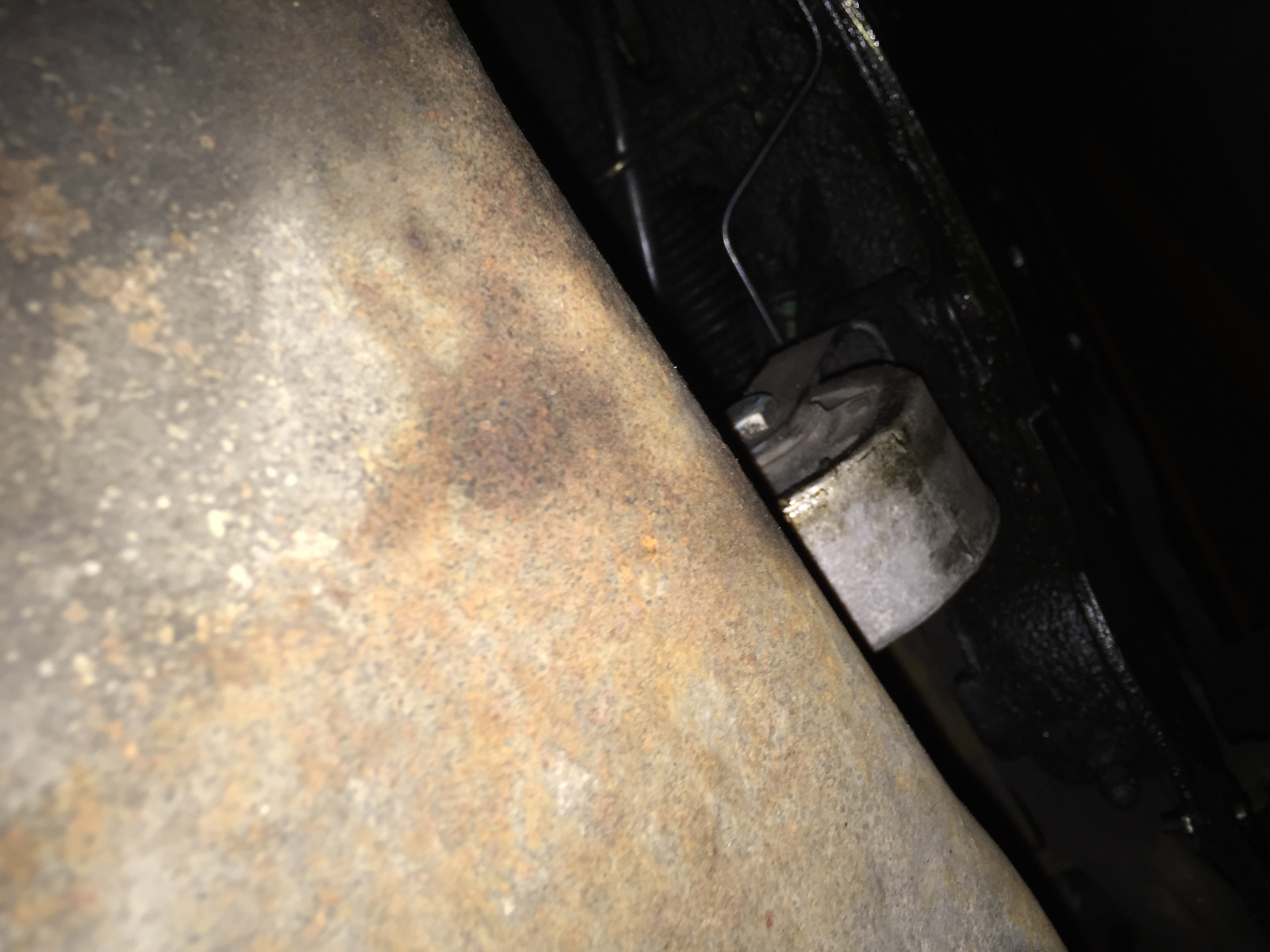

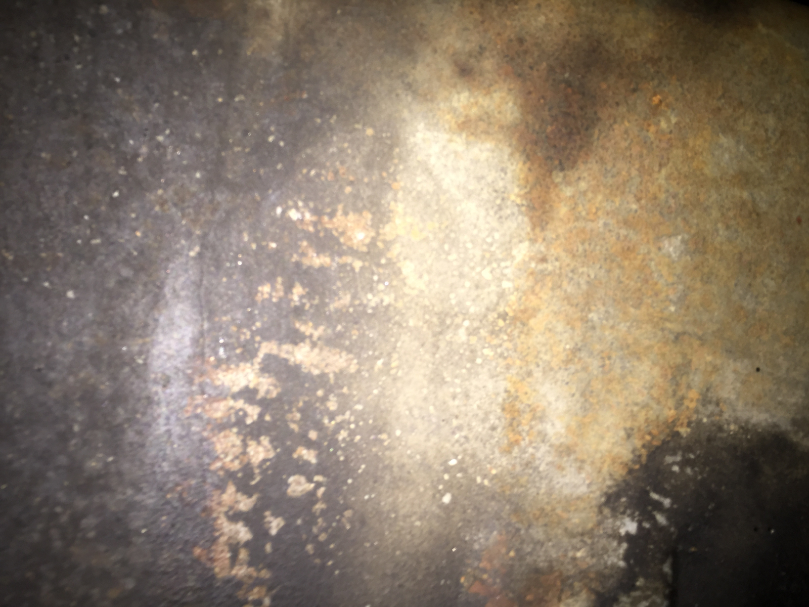

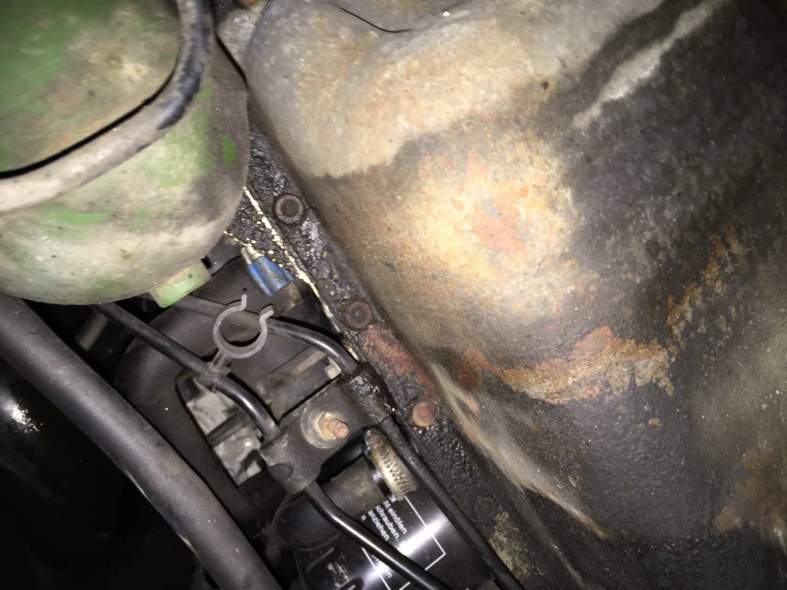

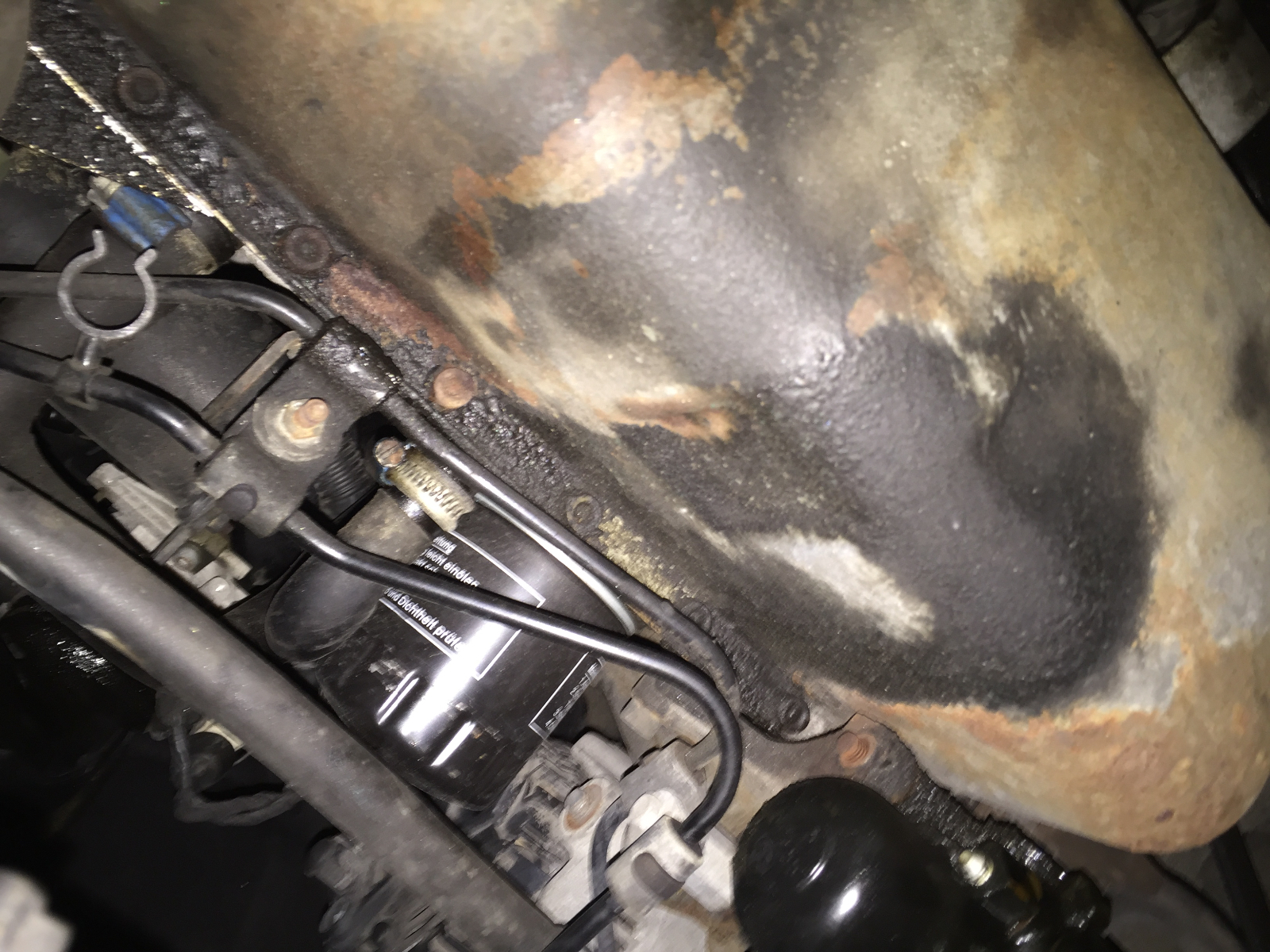

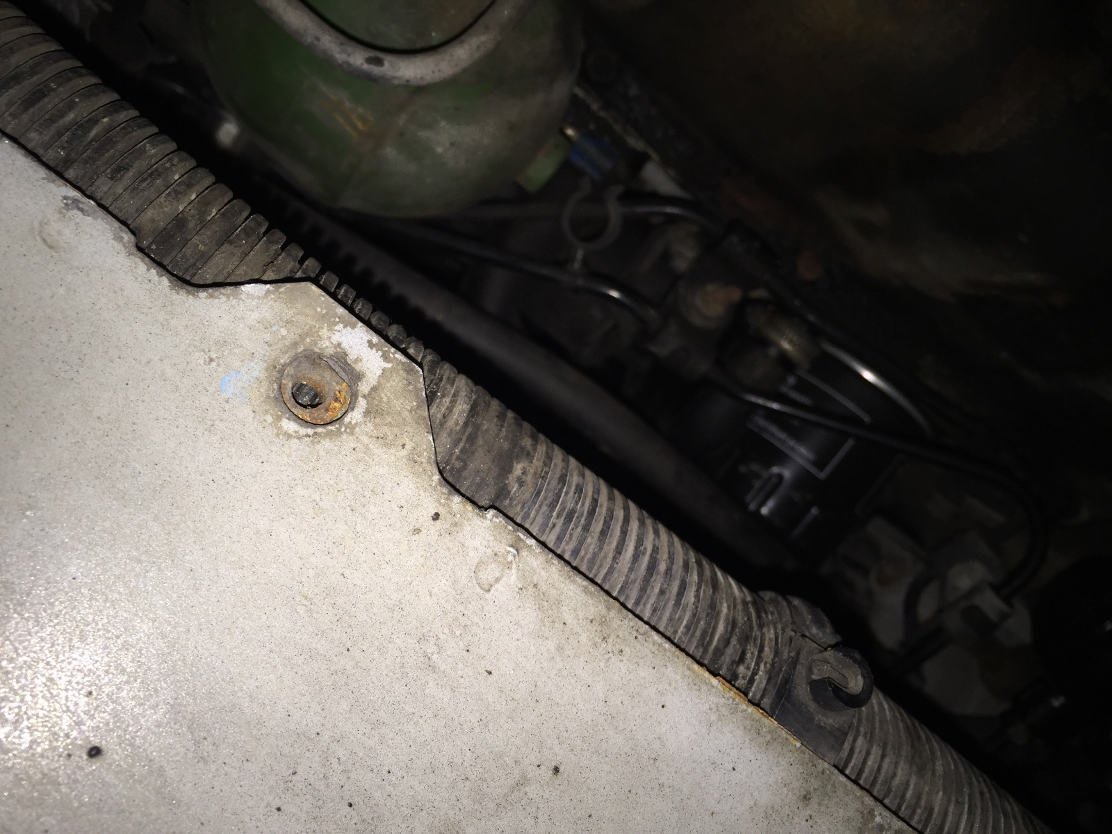

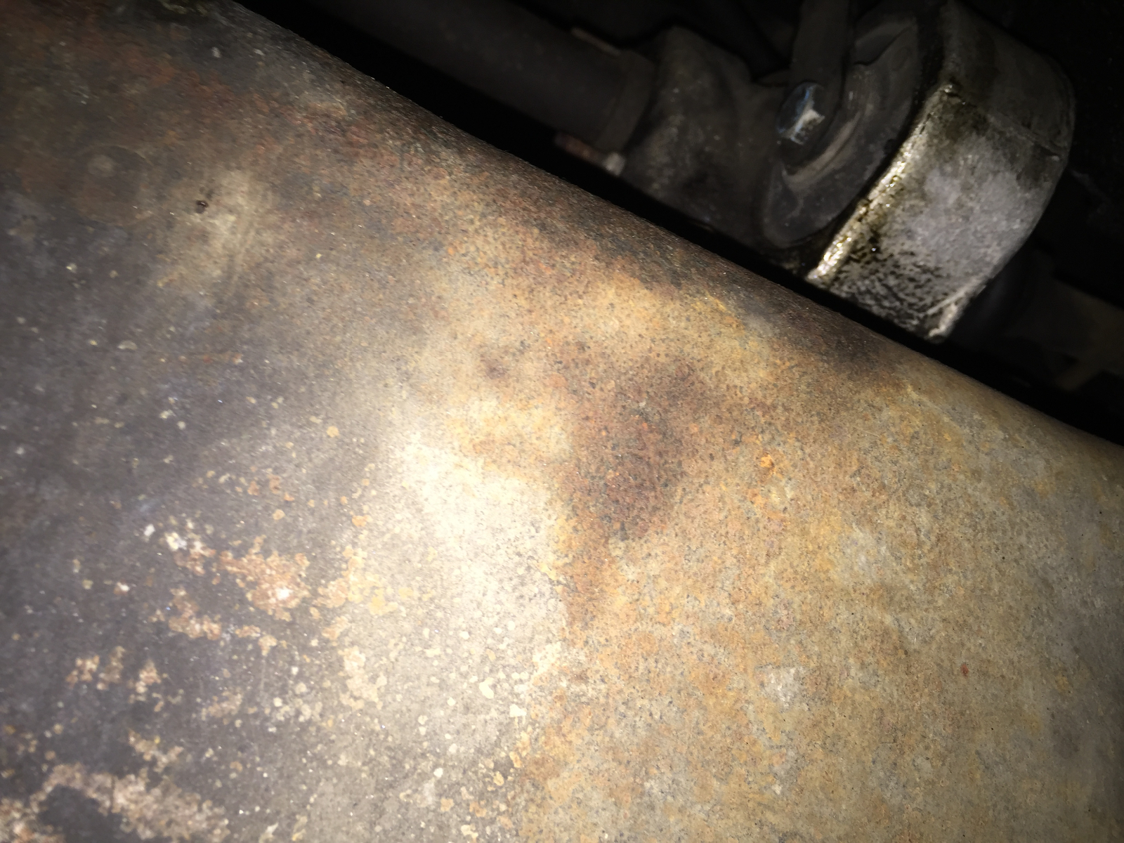

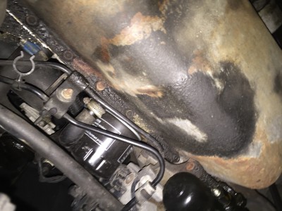

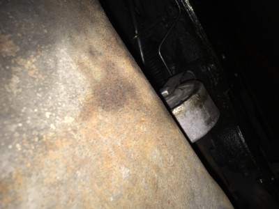

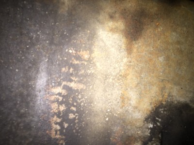

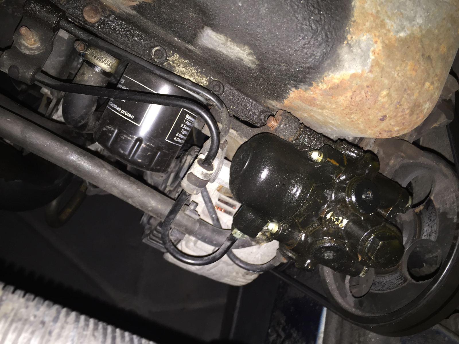

Under the car, mayve doesnt tell you anything but i crawled down in the dark and took some pics
Re: Bought a MK1, and just noticed that the engine probably is blown (links included)
I think you should take the advice that's been given, it sounds to me like a problem with the auxiliary belt or tensioner and maybe not an expensive job to fix, get a mechanic to look at it.
I had one of those where a bolt securing the tensioner had sheared off allowing the belt to run off centre, that caused similar rattles to what you are getting.
That does look and sound like it's the outer crankshaft pulley that is loose.
The reason it's better at higher speeds is because it's turning faster and is at a more consistent settled speed.
So yes, I'd get that pulley looked at ASAP. Maybe you could crawl under youself and have a go with a spanner to start off with, I think it's quite a big size (maybe 27mm?). But to get any kind of socket on it, I think it needs the engine dropping down, or lifted up. You will need to torque it appropriately.
Here's another thought, behind this pulley is the timing belt cog, I hope that is OK, I would assume it is if it drives smoothly, so cross that bridge when you come to it.
Other than that, the engine bay looks quite clean, tidy and dry.

That auxiliary drive belt needs replacing NOW before it shreds any more and bits of it get tangled up in the timing belt (their crankshaft pulleys are stacked side-by-side) causing the cam belt to jump one or more teeth! That would be the end of the engine.
To change the auxiliary belt or even its crankshaft pulley DOES NOT need the engine to be raised/lowered or even have its mountings undone. I speak from experience of replacing the alternator on my daughter's 2.0i Xantia in her drive one Saturday when we were staying for the week-end and I didn't have my proper tool kit with me either, only the small emergency kit in my Xantia. In place of axle stands, I borrowed 4 big concrete blocks and some off-cuts of timber from the next door neighbour who was having an extension built! Changing the alternator is quite a lot more work than the simple job of changing just the aux belt - I'd agree that an hour-and-a-half is a reasonable time.
The crank-shaft pulley bolt is probably the same as on the 1.9TD - 22mm hex. If you have to buy one, buy a hexagon (not bi-hex) impact socket. You would also need a LONG (900mm/36") 1/2" drive 'breaker' bar as the bolt should be VERY tight. BUT the crankshaft pulley ONLY needs to be disturbed if it is loose!
If you look at the Wiki on changing the timing belt (that's a much bigger job), the Sequence of Operations items 1-5 list the tasks for changing the aux belt. If you search the web you may find a bootleg download of Haynes' Xantia Manual, this explains the job in quite good detail.
