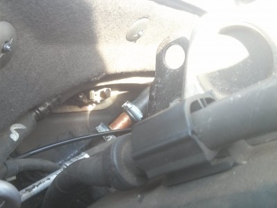

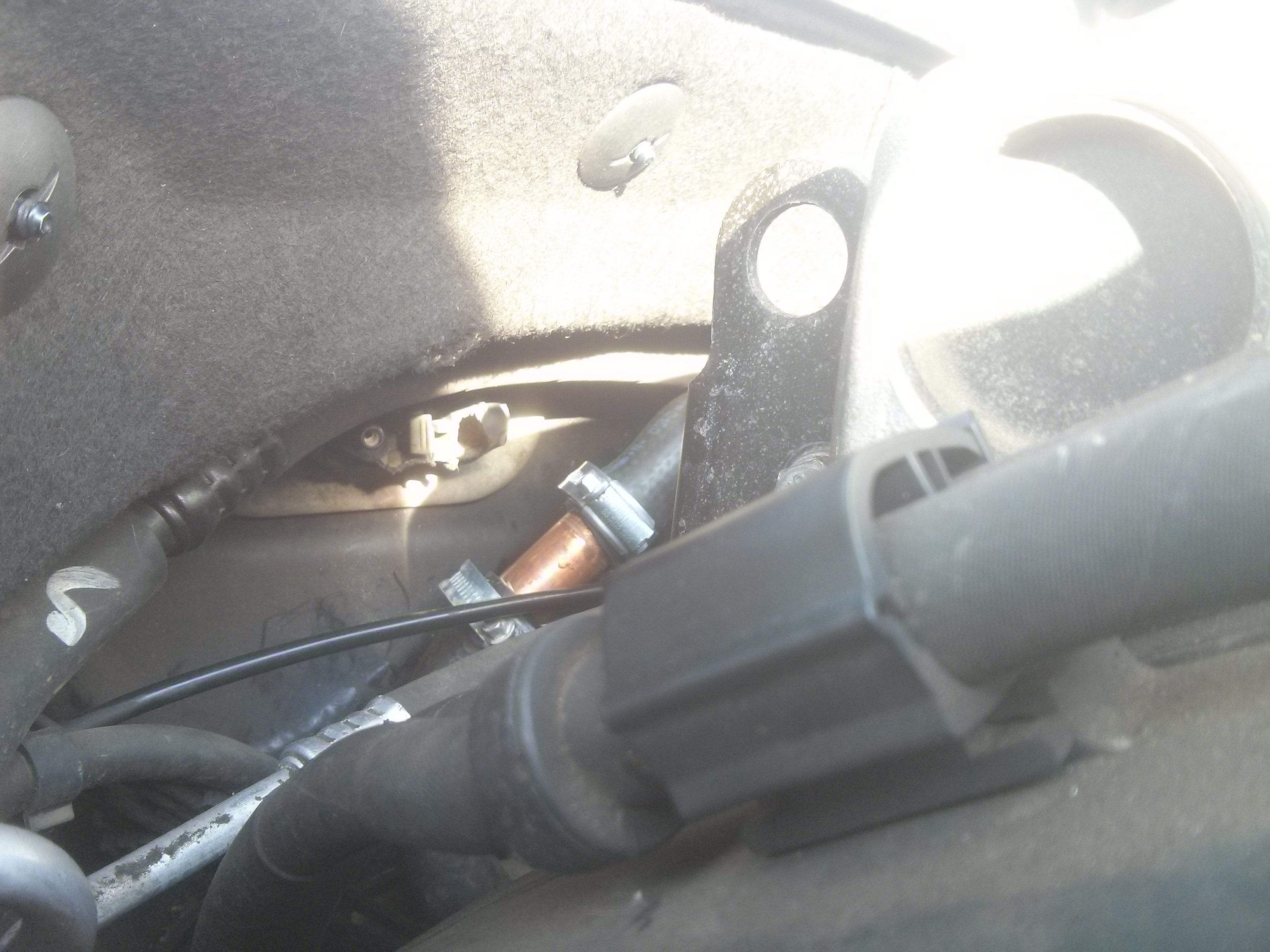

The hoses and the matrix are fully intact, the issue is that the elbow is only about half there.
I'm just off to take a picture now which I'll post this evening as I totally forgot today.

Very difficult to get a picture but hopefully the above shows what's left of the elbow.
