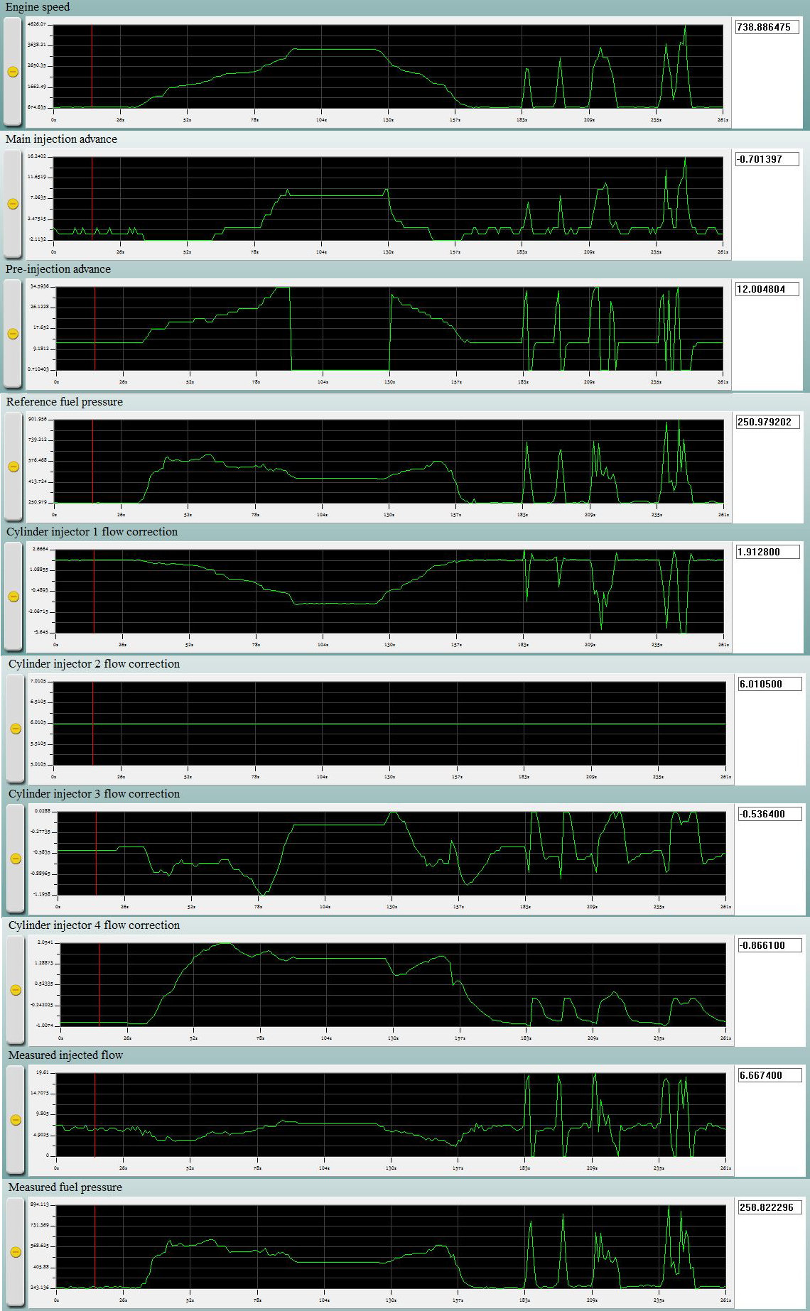

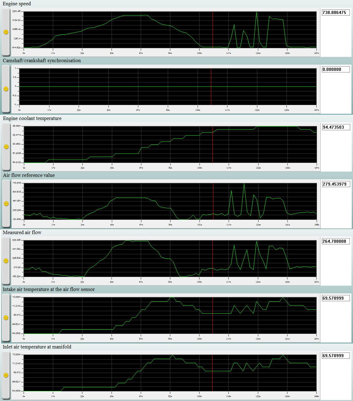

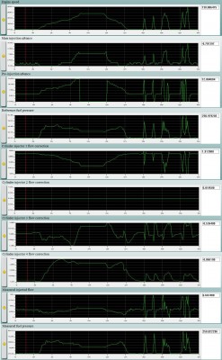

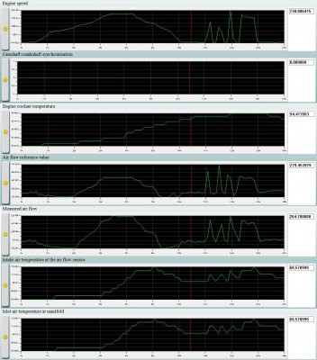

OK I've tried to include my live data capture below. If this works then the clues to my problem may be obvious to someone. Basically the recording starts at idle, after a few seconds the revs rise slowly to approx 3000rpm and hover there for another few seconds before dropping slowly again to idle. After another few seconds there are several quick blips of the throttle and then back to idle, this sequence can clearly be seen on the engne speed graph.

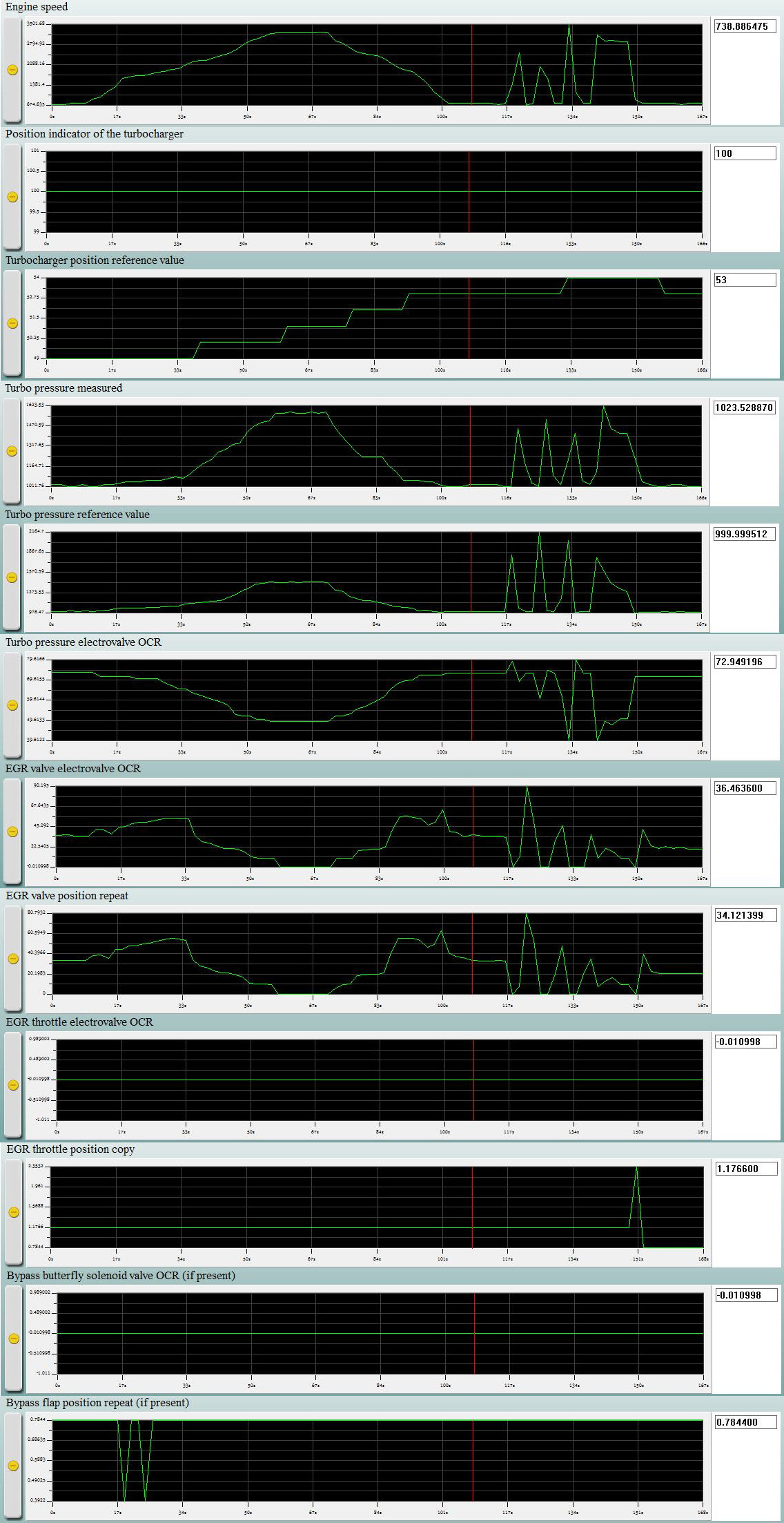

EGR and Turbo data... a few strange readings here!

Mervyn44
- Posts: 36
- Joined: 23 Apr 2017, 19:41
- x 4
Re: Mysterious injector issue - the story so far...
I put a blanking plate on the EGR valve yesterday and replaced the fuel filter - no difference, in fact the car actually seems worse. Sounds and feels rough (knocking) under load so I'm still reluctant drive it further. Seems to idle reasonably decently now (even before doing this recent work) although the clicking noise at idle has returned... sounds like a hollow metal clacking sound, a bit like tapping on an empty paint tin. This sound is not regular so I'm assuming its nothing serious such as internal engine damage/wear. It is intermittent, kinda goes... clack, clack, clack... nothing... clack... nothing... clack, clack. sort of random! It seems to be coming from the back of the engine (toward the bulkhead) but this could be misleading, its not coming from the injectors. It is quite noticeable both in and outside the car.
I've done a continuity test on the injector wiring harness, all seems fine.
I think I've eliminated most possible causes. The strange diagnostic readings on cylinder No.2 can only be due to an ECU fault or a valve/timing/compression problem on cylinder No.2 but compression tests come back fine. I was wondering if it could be a crank/camshaft sensor issue but surely this would flag up an error code and affect all the cylinders? Are there individual magnets on the cam/crank which correspond to each cylinder? if so could one of these be damaged/displaced and therefore affect only one cylinder and confuse the ECU?
I still don't know if this weird No.2 injector data in the diagnostics is even the cause.

Did you say that injector no.2 had been replaced? If not maybe a working one from ebay could be sourced cheaply?
As to the EGR, I would try blanking it off on a strictly temporary basis during trouble shooting, to see if it is getting stuck open or leaking in some way.
Bypass butterfly solenoid valve is a thing some HDi engines have whereby the air can pass directly from the turbo output to the intake manifold without going to the intercooler.
EGR throttle electro valve is a butterfly just before the inlet manifold to help cause a partial vacuum in the inlet manifold to draw in EGR gas.
