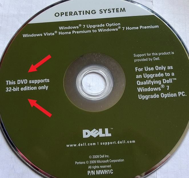

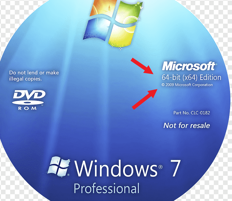

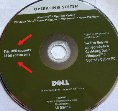

Not necessarily James. The optical media (installation DVD) will state the Operating System Version. This will depend on what the system was shipped with when new and is usually either 32 or 64 bit - not both - see where I have arrowed in red on typical installation media.
If you don't have a 32 bit media disc, you can download it free from Microsoft, but of course will still need a licence key to do this from the Microsoft site:

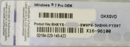

So if you have your licence, usually installed on a sticker on the laptop and will look like this - it is the 'Product Key you need'
One other thing to watch out for is that some product keys are only for manufacturers as part of volume licencing so the product key may not allow you to download it.
