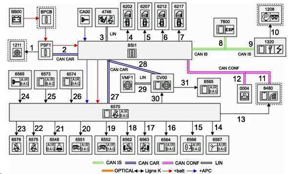

Re: Air Bag/pretensioners Fault Citroen C5 2009
Here's the electrical diagram and component list in case it helps:
Click to Zoom
Components Description Table
(Ignore 8480 - you won't have this - it is for the RT4 Navidrive which triggers an Emergency Phone Call when the Airbags have triggered).

| Element | Designation |
| BB00 | Battery |
| BPCB (*) | Battery cable protection unit |
| BSI1 | Built-in systems interface |
| CA00 | Ignition switch |
| CV00 | Switch module at the steering wheel |
| PSF1 | Connection board - fuse box-Engine compartment |
| VMF1 | Steering wheel with fixed central controls |
| 0004 | Instrument panel |
| 1208 | diesel injection pump (Diesel engine) |
| 1211 | Fuel pump and gauge (petrol engine) |
| 1320 | Engine ECU |
| 4746 | Seat belt not fastened warning lamps unit |
| 6202 | Driver´s door lock assembly |
| 6207 | Passenger´s door lock assembly |
| 6212 | Rear left-hand door lock assembly |
| 6217 | Rear right-hand door lock assembly |
| 6548 | Airbag module (Steering column) |
| 6551 | Curtain airbag module (Right hand ) |
| 6552 | Curtain airbag module (Left hand ) |
| 6562 | Side airbag module (Right hand front) |
| 6563 | Side airbag module (Left hand front) |
| 6564 | Airbag module (Passenger) |
| 6565 | Airbag module (Driver) |
| 6566 | Side airbag module (RH rear) |
| 6567 | Side airbag module (Left hand rear) |
| 6569 | Passenger’s airbag deactivation switch |
| 6570 | Airbag ECU |
| 6573 | LH lateral sensor |
| 6574 | RH lateral sensor |
| 6575 | Front left pyrotechnic pretensioner |
| 6576 | Front right pyrotechnic pretensioner |
| 7800 | ESP ECU |
| 8480 (*) | Data communication ECU RT4 |
| (*) According to version |

Thanks Marc, I will try that, my son said the fault came on just after he got on the motorway on his way to Grimsby, he had borrowed it to tow my trailer to his girlfriends to bring back her 126 for me to do some work on, so he was towing an empty trailer at the time. It has not gone out since. I can ask Peugeot / citroen in Birmingham but I have never found one you can talk to, just the front desk which is why had had been trying to avoid that and the expence. The other thing is would just swapping the 4746 unit clear the fault if it was faulty or does it need to be configured?
- x 6956
4746 is the roof console seatbelt warning / airbag LED that I believe is the unit that you have already tried Nick - unless I've read your post wrong? But that is one of the suspect units according to the fault code table above.
Try the reset first and see if that helps - if not then there is something it is not happy with - Backup Mode 2 applies selective inhibiting of one or more pyrotechnic components in this state, so an MOT failure until resolved as you say.
