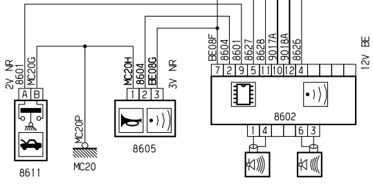

I think he means it's not physically connected from the steering wheel controls directly - the signal is sent to the BSI (as you can see in the diagrams) and the BSI commands the horn to activate.

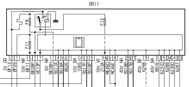

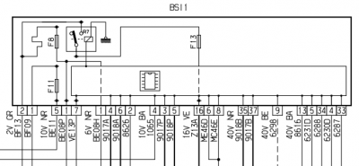

ekjdm14 wrote:Speaking of the OP's issue, do we know where the relay is? internal to BSI/BSM or separate? if it's accessible then it could be opened up & the contacts inspected to see if they've arc'd themselves together (had that issue with air horns on my old CX500 bike! lol)
I hear you! It's linked to the anti theft alarm and seems to be an integrated relay within the BSI (R7).

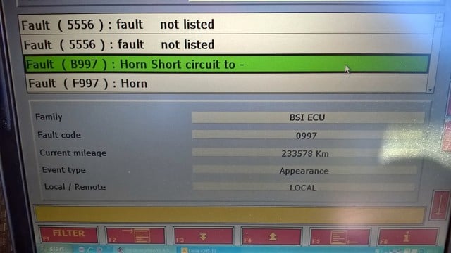

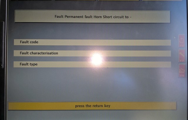

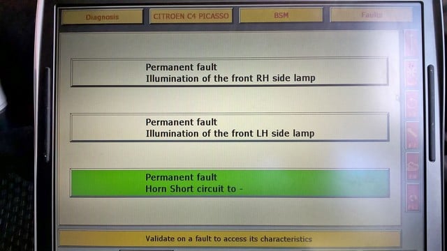

I've had it on the Lexia and it's thrown up this:
Does that clarify anything?

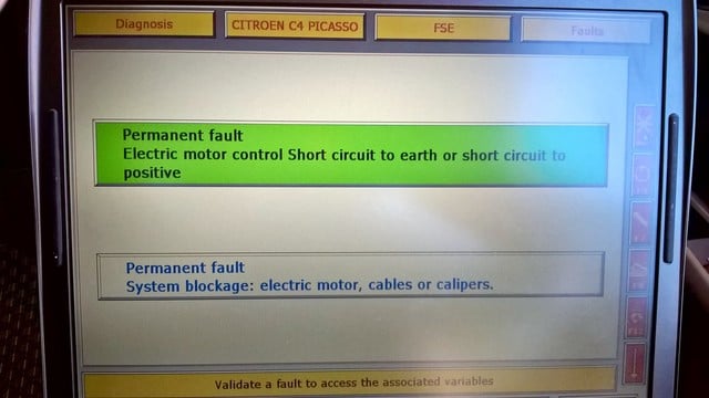

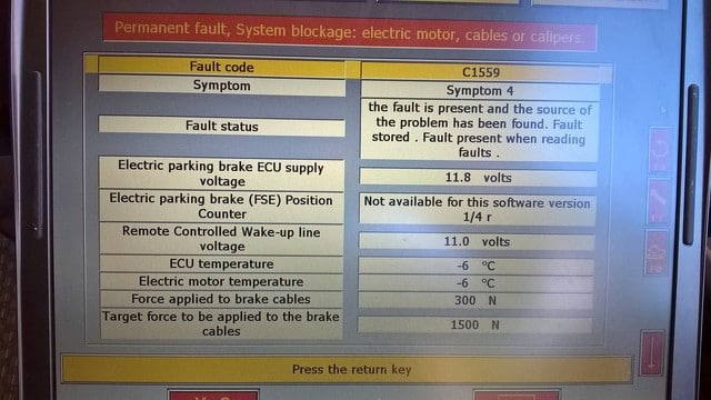

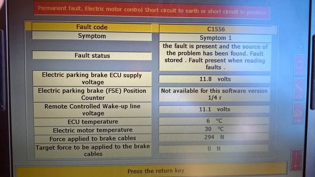

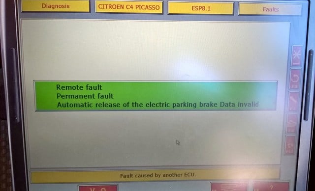

Something else came up whilst I was having a look see. Seems there is a fault in the parking brake:
Does that give enough info to point me in the right direction?
