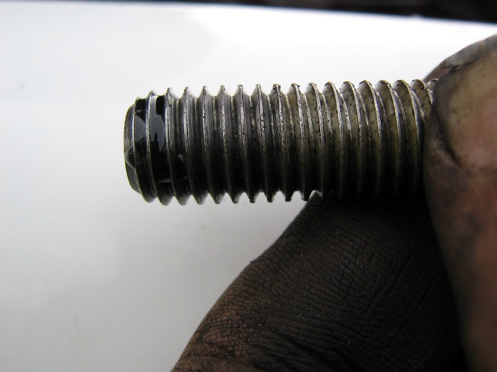

NB: any thoughts on at which point you're just wasting thread lock by applying too much?
See pic: about right? too much?
Puxa
x 1746
Re: Cuts Out Suddenly, Restarts immediately
Not enough. Thread loc, like superglue, works by air being excluded, and if you don't apply enough of it, air remains in the inevitable clearance between the two threaded parts. With a reasonably generous coating of thread loc, all the thread surfaces are decently coated, and air is excluded.

thanks exec :) appreciated
