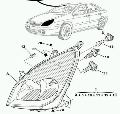

This is for a Mark 1 2004 model with discharge lights, so should be the same.
(11) is the D2R Xenon Dipped Headlight and does not have the ballast unit shown in the picture (see further down)
The main beam headlight bulb (10) is an H1 55W bulb. (12) is a W5W Side light and (5) is the indicator PY21W. Your D2R Xenon bulb is 35W and should be replaced with the same. It looks like the one in the photo. The headlamp incorporates the beam corrector, linked to the ballast and the control unit.

As per your VIN - the diagram I posted is still relevant and that is the original kit that was on your vehicle. It's really hard to work out what has been done. On the originals the ballast and control unit is incorporated into the headlamp unit, so I don't know what has been done to your car - but the original kit should be plenty bright enough. I take it the headlight wash system works when the lights are on and you activate the wiper wash / wipe?
To post a picture from your PC or mobile - just click the 'Full Editor & Preview' button next to the submit button below, then select the 'Attachments' tab, then 'Add Files'. You can either browse to the image on your PC you want to upload, or on a mobile it should list your photo library locations. Select the image, then add a description on the 'File Comment' box that appears, then press the 'Place Inline' button and submit or preview your post.
