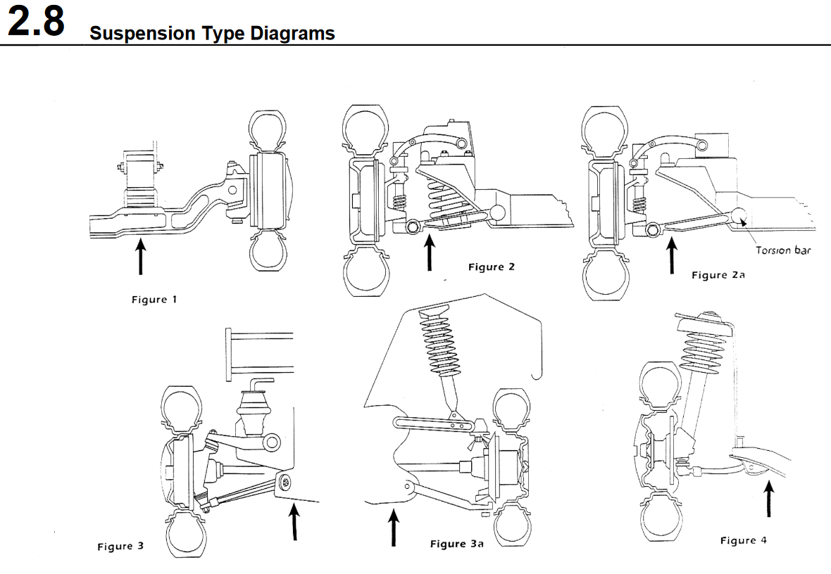

The ramps where I take mine have swivel plates on so they can turn the wheels and check the steering / suspension / joints etc easily enough.
Here is their diagram - so which do you suppose either of the C5 systems comes under? (Click image to enlarge) In either case - if they do need to jack up the front - it must only be the front for Class 4 passenger cars - so with the rear wheels supported there should be less stress on the system.Vehicles with suspension types as shown in Diagram figure 2 and 2a must be jacked so that the suspension spring force is removed from the ball joints, i.e. suspension arms must be clear of their stops. Failure to do this can result in defective joints being overlooked:
