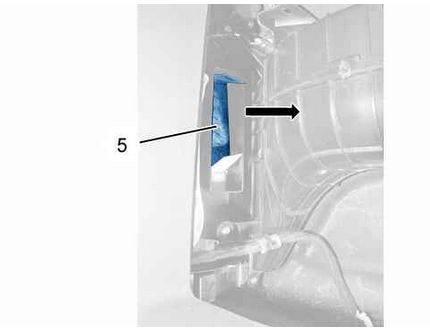

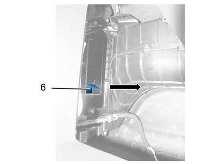

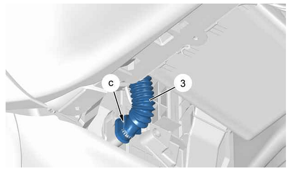

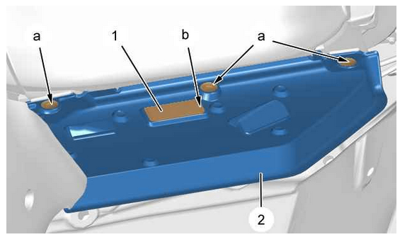

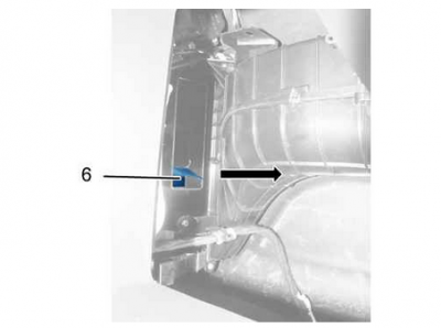

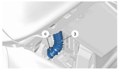

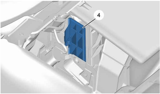

@ Carfreek:
Ok, here is the procedure for your particular vehicle - being a Left Hand Drive, I assume this is slightly easier: Unclip:
Remove the trim (2) under the dashboard.
N.B. : Compress the pollen filter (5).
Remove the first pollen filter (5) (In the direction of the arrow ).
N.B. : Compress the pollen filter 6).
Slide the second pollen filter (6) upwards.
Remove the second pollen filter (6) (In the direction of the arrow ).
- The lamp (1) (at "b")
- The clips (at "a"
- Unclip the air duct (3) (at "c").
- Detach the air duct (3).
Refitting
Fit the new pollen filters .
Proceed in the reverse order to removal.
Check the air flow of the air blower by operating it at different speeds.

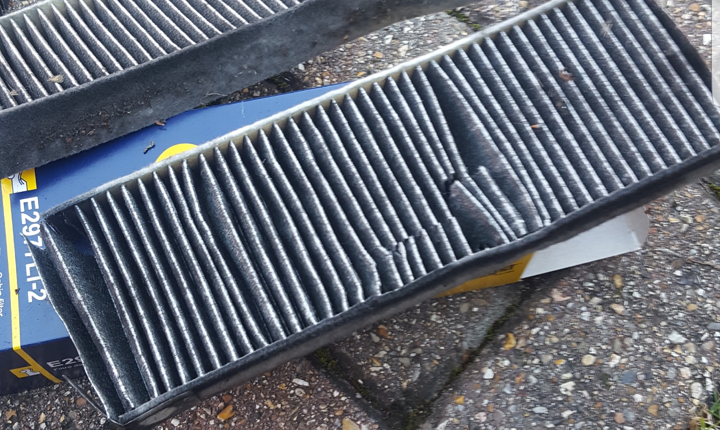

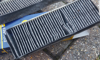

I don't understand what all the fuss is about. I've just timed myself doing the pollen filters on my 08 plate RHD manual gearbox one. From opening the car door to popping the last fastener in place - 9 mins 11 seconds.
I do it sat on the floor outside the car then my arm is pretty much straight rather than trying to bend it around the place.
Mine don't look like they've ever been changed!

Carfreek's is a LHD Mike - so some different trim to remove - but doesn't look too complicated . Yes they do seem to have seen better days those 2 you removed. I pulled out half of Epping forest when I replaced mine - and considered sending it to the local school's Biology Department for some forensic analysis considering the rest of the crap that was in there - completely disgusting.
