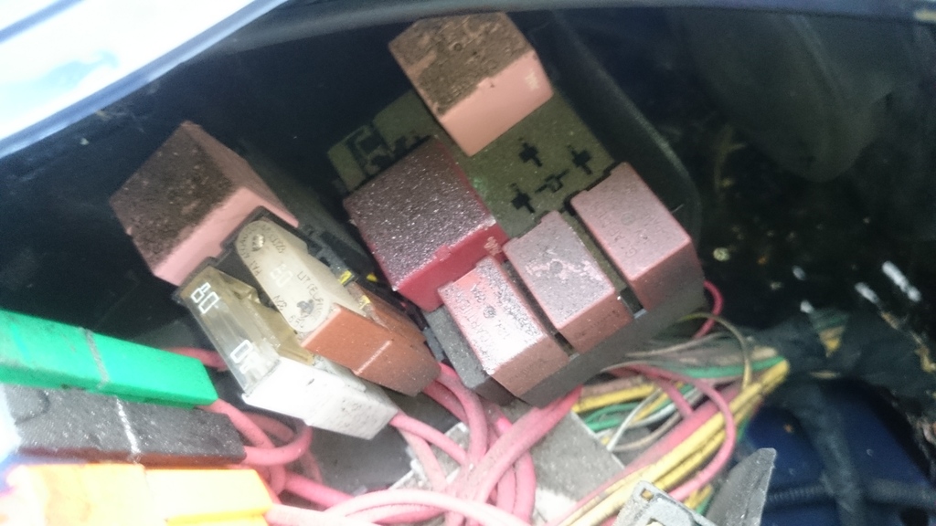

Would this be normal dirt and oil on bonnet fuse box and also waiting to make car a bit safer to take it to auto electrician so which fuse is for power steering thanks

That sounds good on the alternator side, whats the battery giving with the engine off?
For the age of your car those relays and fuses don't look particularly bad, Renault don't protect them well at all. They do look like you may have reached the stage where there are connections to clean up. I don't know the systems on your car so I think maybe wait until the auto electrician has had a look.
Fuse should be F39 (15A) in the passenger side panel, Renault draw handy little pictures on the inside of the cover so double check it's the one with a picture of a steering wheel.
Is the problem happening after you've driven for a while or does it happen quite soon after starting it up.
