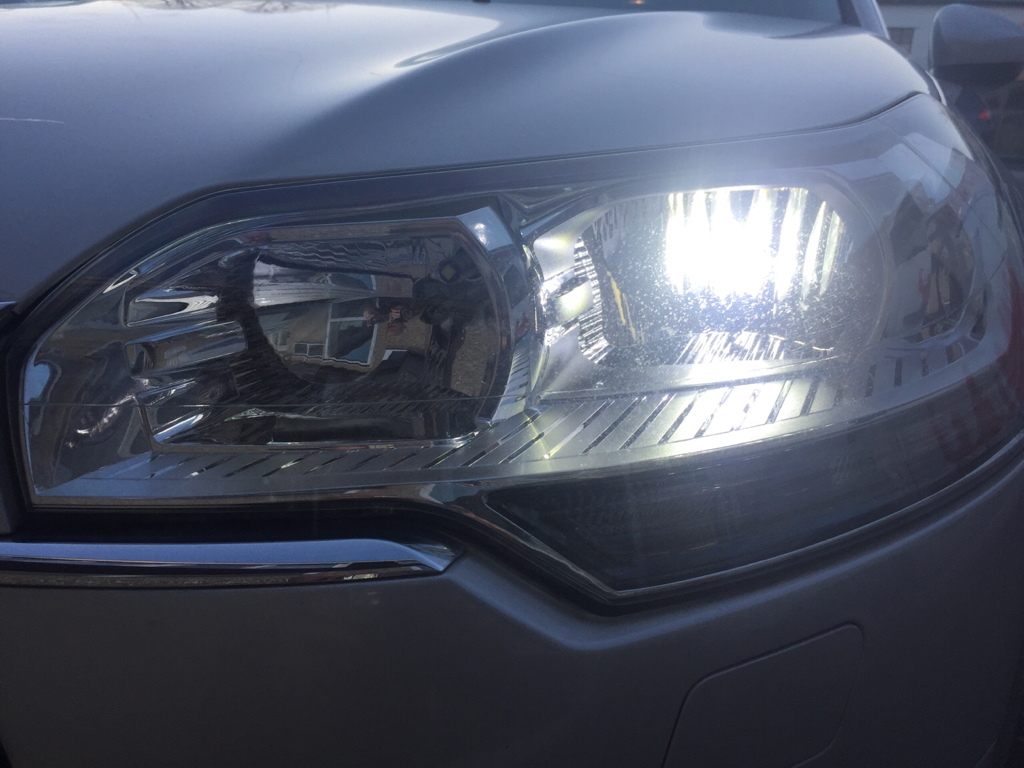

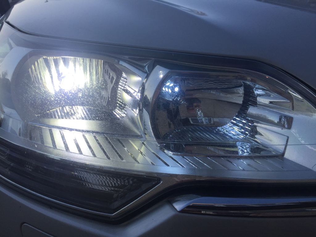

I used these: - but am not happy with them - they have 30 x 1210 SMD leds on each - but they are still not bright enough, although the colour temperature is a a crisper white. I will be replacing these in the next few weeks with a newer design which will improve matters -so I wouldn't recommend these. Below is a snapshot of the before and after with the current LED reversing light replacements: These are the current LED replacements - but will be looking for some new ones.van ordinaire wrote:Personally I'm for LED's in most applications (all my rear light conversions have been very red, rather than very bright) but found that they're poor for illumination, so am interested what GiveMeABreak used in his reversing lights (I know there are some listed specifically for that application)

I am going to try and get some sylvania leds or osrams and test them out. I'll leave pics as soon as I can do it.

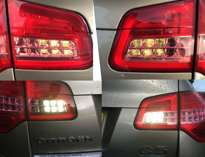

Does anyone have a schematics of the rear lights? I really need to know what bulbs it uses.
I would also like to know what bulb you've used for the reverse. I also believe the same thing. There is badly any light being poured out through that gap. Let me know your newer replacements. I would assume it needs some decent CREE leds to pack a serious punch. Yours not only looks whiter, but looks brighter as well. Probably just not enough for you.
Ok here are the bulb types (X7 Saloon) - I assume this is what you mean when you say 'schematics'
Rear:
The 2 Boot Lamps:
Top = Side lamp: R5W
Bottom = Reversing Lamp: H21W

Exactly what I was looking for GiveMeABreak, thank you!

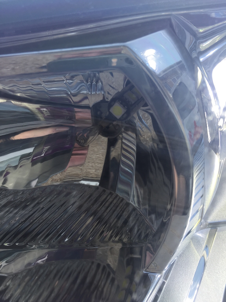

I read this post last night and checked my lights this morning and realised of them doesn't work and I think they are after market LEDs?
What it looks like working on the drivers side
Anyone got a link to a standard set or a better after market option?

They don't look right, I'll look them up in a bit. Your DRLs are at the bottom, where the bodywork meets in the picture and are probably not enabled - a Lexia can enable them, if there is no option to turn them on via the left hand steering wheel (wheel button) in the lighting menu.
