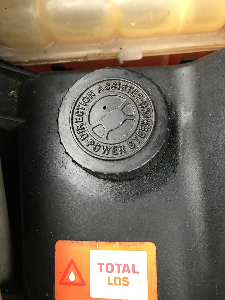

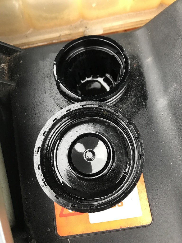

I have found that the cap on my C5 is vented. The cap is marked "DIRECTION ASSISTEE - POWER STEERING" and has the symbol of a steering wheel. Within that wheel, in the 12 o'clock position, is a small (2mm) hole. This is the vent. You can, from the outside of the cap, blow through it (into the tank), but I tried the other way and it will not let air flow OUT of the tank). If my original cap had not been vented I was OK, as I got a vented cap from a scrappy (I intend to fit a wheel valve to it, so that I can then pressurise the system if I have had to work on it) for a couple of quid.
I did notice that, on the tank, there are warning labels that could imply the system should only be worked upon by a qualified Citroen technician. To somebody who is not mechanically minded that could put them off even loosening the LDS cap.
The cap looks like this, but the rubber washer is missing from the inside of the cap;
