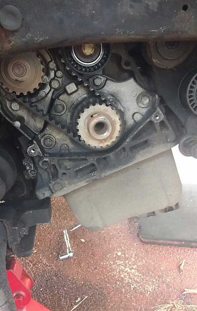

I have photos of floating crank . How the feck do I post them on here

Is that keyway gap really normal? I ask as it's certainly not the case, to that massive extent anyway, in an XUD...
I take it there's no such enormous gap on the crank pulley keyway...
top drive
- Posts: 20
- Joined: 15 Feb 2012, 13:22
- x 2
Re: DW8 cam belt
Aye , I checked it out. Not even all dw8s have it im just lucky like that
CrankWoodruff's tight in slot on crank shaft
And tight in crank pulley
Reckon it's to aid assembly tbh.
But it important to put the 2 mm dril in to centralise the keyway ion the key and time from cam down of you'll likely end up a tooth out.
