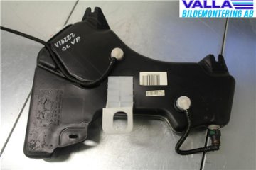

I've already checked this out on a C5 (X7) 2.0 HDi 150 PEF (DW10FD) Manual gearbox 6 with stop and start (Blue HDi) Year 2015 and can confirm it has a PEF (Particle Emissions Filter) tank as shown below, part 1500 NK. This is in addition to the Adblue as I've said.

Re: C5 X7 risk of particle filter clogging
??, has the capability of the \PSA system increased so is still a better performing system than the other manufactures ?
- x 6960
? Not sure what you mean Alasdair - part of the debate was whether the newer blue HDi engines which use the UREA (Adblue) to get rid of the NOx using SCR also have the diesel additive for the particulate filter. And they do, so an improvement over the older system for sure. Can't say whether it is better than other manufacturers' systems that also use Adblue - some of those don't have additive systems for their DPFs and they clog more it would seem.Stickyfinger wrote:??, has the capability of the \PSA system increased so is still a better performing system than the other manufactures ?
