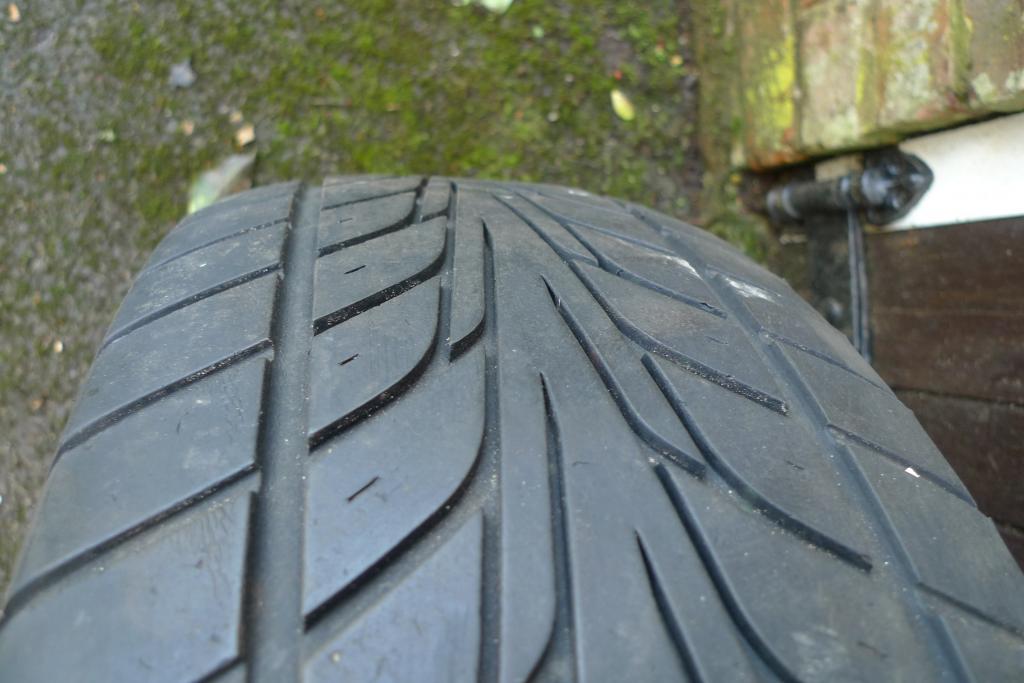

What size wheel is it and what size and make of tyre is fitted?
- Posts: 6847
- x 3566
Re: Citroen C5 2009 May I use the same alloy wheel bolt on a steel wheel?
If that's a question for me, then it's a 17" with a Primewell 225/55/17. Date stamp: 4010Paul-R wrote:What size wheel is it and what size and make of tyre is fitted?
I don't think the wheel has ever been used, but I swapped the tyres 'round some time ago - hence it's a worn tyre on it.
