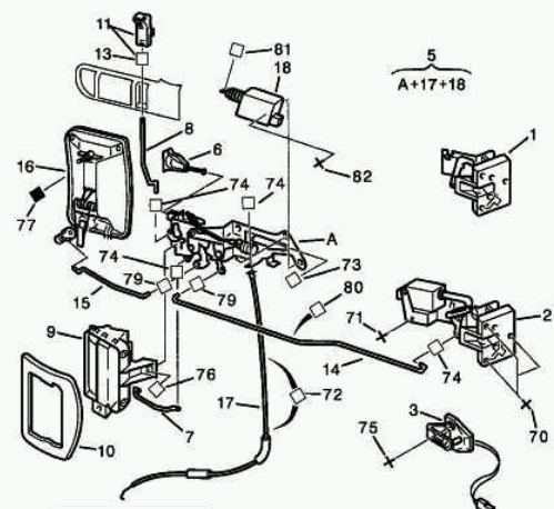

Thanks to all for your help. The clutch cable is now fitted and the gear change cables are in my possession ready to be fitted.
Yesterday the passenger side sliding door wouldn't open. I saw the replacement lock pin on eBay for about a tenner, but there are loads of Berlingo ones on there for 2-3 or 4 quid. Does anyone know if they are the same part? They certainly look the same.
Sent from my Wileyfox Swift using Tapatalk

Re: Citroen Service request.

322262676135 I can't see it on there but this is the eBay item number. It does actually look different to the Berlingo one looking again.
Try this:Yesterday the passenger side sliding door wouldn't open.
Push outside handle fully forwards (towards front of car)
Lock, Unlock, using remote
Now try it.
Hope it works for you.

That doesn't help I'm afraid - that's just an ebay number and not a part number. If the fix above doesn't work, you'll have to post a picture up or try and describe the part a bit better.demag wrote:322262676135 I can't see it on there but this is the eBay item number. It does actually look different to the Berlingo one looking again.

Just tried that Richard and it worked thankyou.
