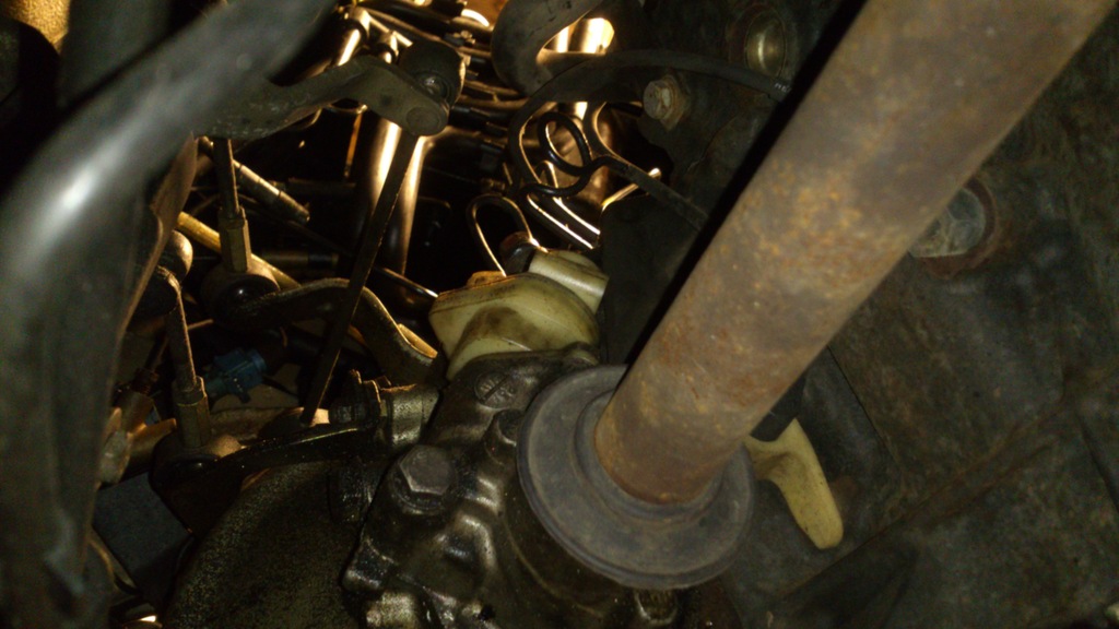

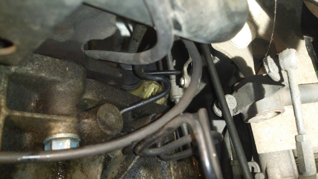

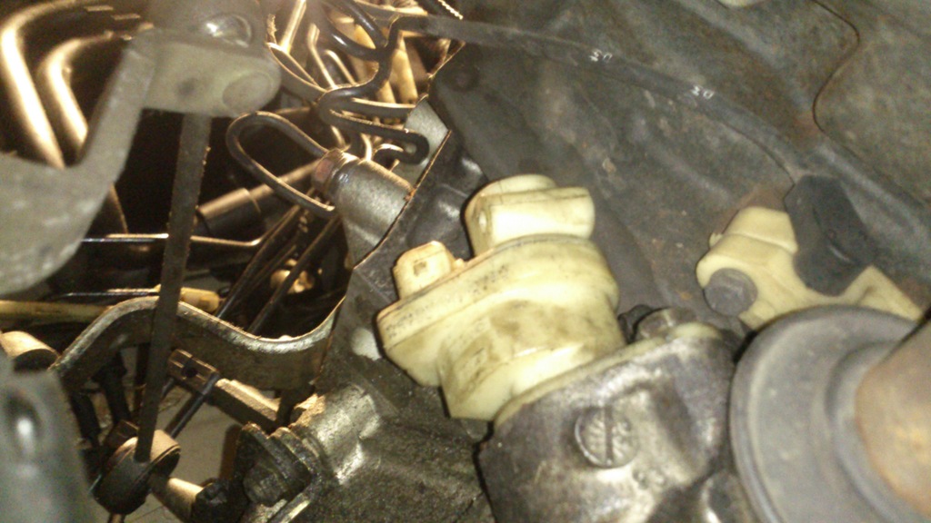

So, a bit of movement - the speed sensor unplugged

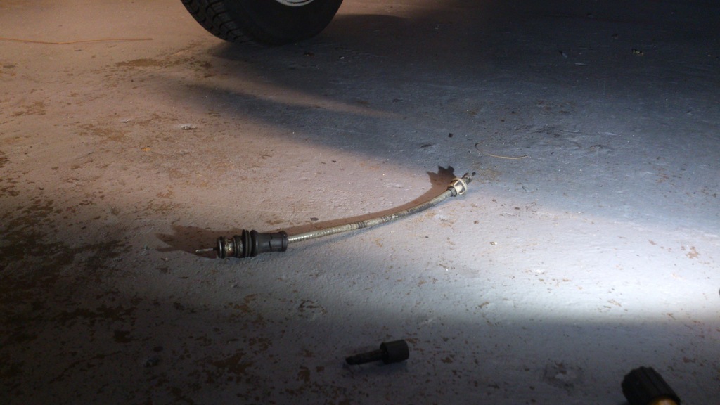

Then out with the smaller speedo drive cable
(that's a 2CV wheel creeping into shot there)
Hope the gearbox doesn't empty half its oil if I remove this!

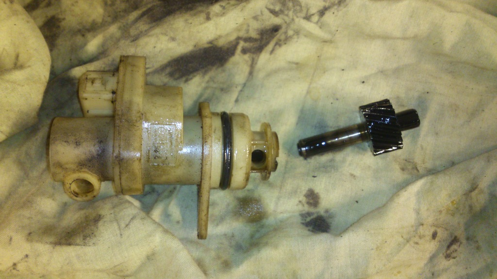

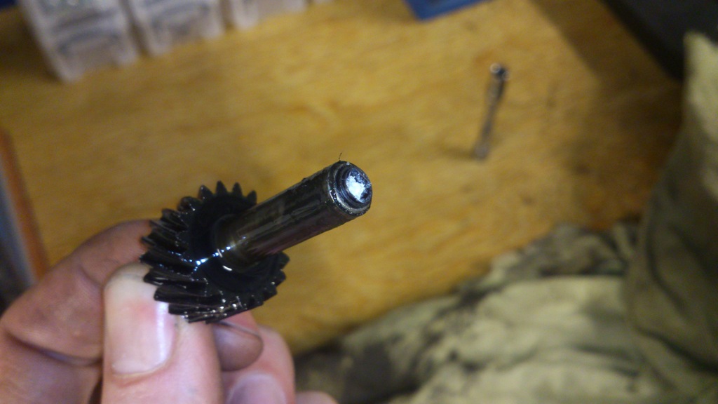

Anyway enough of my usual photos excess, the speed sensor appeared physically ok but the drive from that pinion you mention is broken
I'm guessing that this nylon pinion is actually not part of the speed sensor. If anyone has access to the service Citroen microfiche type diagrams and could look up this part it might be similar on many models (?) It looks a bit like the square section drive that's snapped would actually pull out from both the pinion and the speed sensor as though it is just a sort of key drive. If it's NFP I might be able to fashion a bit to replace it.
Anyway this explains a good deal of the problem! the hydractive ECU was getting no speed information as the speed sensor was not spinning to give the pulses. It was however electrically ok as it was passing the ECU's test of componenets in circuit since it was connected as normal. This is why it was staying in soft mode all the time, the ECU is happy and thinks the car is stationary. However it doesn't explain why the ecu wasn't responding to the input from the pedal sensor, the only sensor that works below the 30km/h threshold.
I decided in the interim that it was probably better to let it stay in stiff suspension by unplugging the ECU connectors but blimey it's firm! I'll be taking Old Katy in to work tomorrow but might plug them back in as perma soft suspension is maybe better than perma stiff for going across the city..
The speedo not working a week after I had the speedometer etc out to change the bulbs was such a red herring here because it looked like the bulb change was the cause of the speedo stopping working
Graeme M

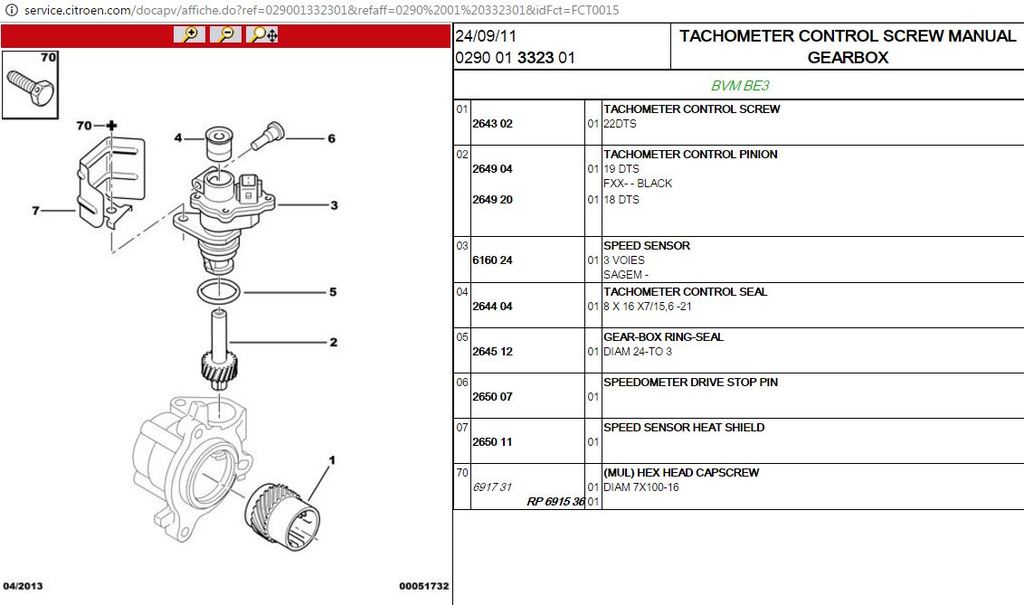

I think that the spindle cog is common with the later electronic speedos, so any BE3 unit should fit, but check the number of teeth.
Also check that the speedo cables spin freely, or you may break another.

Looking at the diagram and picture again, I think that the broken nylon square is part of the sensor, not the cog. The sensors (with pass-through for the mechanical cable) are commonly available on ebay and perhaps amazon.

Thanks all, and I think you're right - the broken drive is part of the sensor but it's prudent to check the cable is spinning too.
The Speedo needle was a little bit wobbly (+/- 5mph) that made me think it was overly lose inside the cable.

If I had to guess at the cause of the problem, I would say that when you refitted the speedometer, the square on the end of the cable did not engage properly, pressing the inner cable into the outer, and causing it to bind, eventually shearing the nylon peg at the sender. It may also have damaged the cable further up.
aerodynamica
- Posts: 1690
- Joined: 26 Dec 2007, 18:10
- x 216
Re: Hydractive strangeness
That's also what I thought but there was a few days where the Speedo was working so I think it was engaged fully.
I've been calling a few places to see about a new cable but need to call into the place to look at the 3 possible cables the guy at AEP found.
