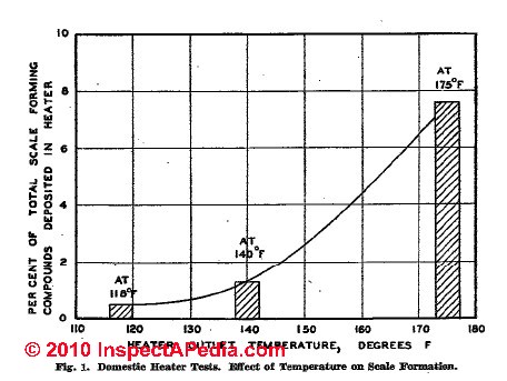

It's amazing how dependent on temperature depositing limescale is. See the graph below and article:
http://inspectapedia.com/plumbing/Water ... revent.php
At 80 degrees C limescale deposits about 6x more readily than it does at 60 degrees C.
The moral of that story is don't let the system get hot, ideally not over 50 degrees, when circulating water without suitable inhibitors present. (EG during a flush)
Same applies to central heating systems too - don't run it at normal operating temperatures until the inhibitors have had time to fully mix around the entire system and definitely don't run it without inhibitors, even for a day or two.
I'm about to do a full drain and flush of our heating system in a couple of weeks and I learnt that lesson the hard way last time. (temporarily running at normal temperature without inhibitor, which deposited lots of limescale in the boiler, grr) This time I will be doing all the flushing cold and adding inhibitor and letting the pump circulate the cold water around all radiators for at least half an hour without any heat to allow it to fully mix the inhibitor before letting it get hot. (Thus in theory avoiding the limescale depositing I had last time)

Very informative graph above. Disn't realise the deposition rate was so affected by such a small temp increase.
