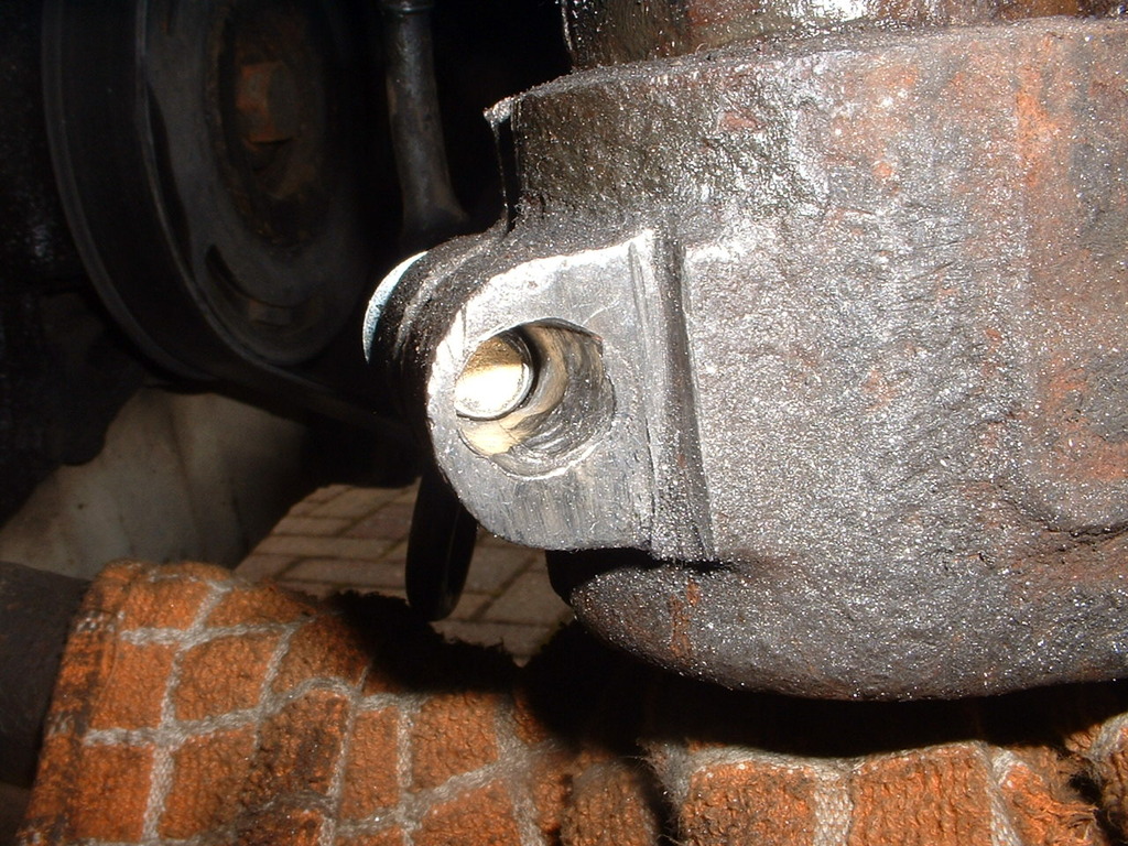

Well job is finished now ... hopefully anyway got a few more bits to sort for the MoT ...
In the end I persevered with the in-situ drilling
we'll never know if the bolt would have drifted out or not but take a look at the later stages and you can just see the edge of the bolt that remained (at about 2 o' clock in the hole) .... cant be more than 1/5 of it left in but it wasn't budging in my opinion .....
Thanks RichardW and Chinkostu for your advice which I ignored in my ignorance.
Next time I'll know the preferred way and leave the pinch-bolt well alone ... tough bugger
THEY were right
