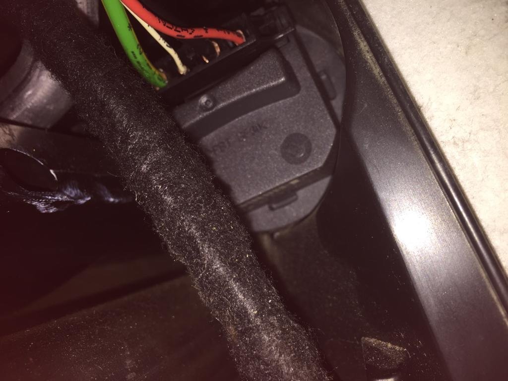

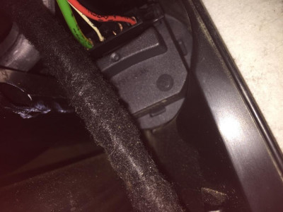

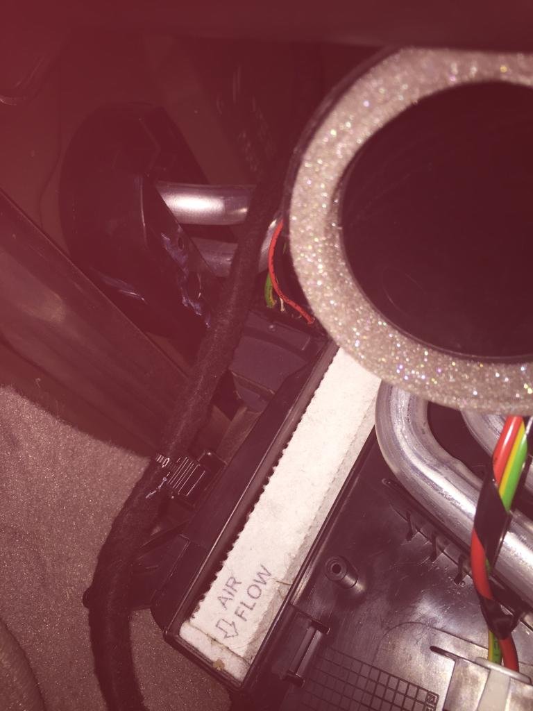

I had another look.....found pollen filter to RHS of footwell. Think I see fan controller up on top left hand edge of this....attached two images and hope someone can confirm.
Other posts on removing the glovebox confused me....must be different year car? (Might have been on Aussie forum)
Any ideas on the part number?
Thanks

No worries - I was going to point you to my Pollen filter changing thread - which has pictures - and half way down shows the blower control module:
viewtopic.php?f=22&t=56903
