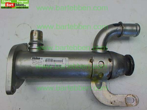

Gibbo the EGR cooler and an oil cooler are totally different things. This is the EGR cooler:
The coolant goes in at the top right and out at the top left (ish), the exhaust gas goes in on the right and out through the EGR valve which is normally on the left - it's not fitted in this photo.

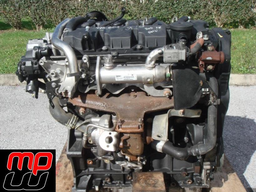

And in the following picture you can see where it is in relation to the back of the engine, and you can see how big it is, you can't bodge anything in it's place easily:
