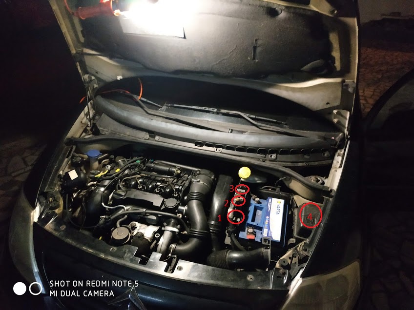

Hello everyone,
i have a Citroen C3 1.4 HDI 2004 that is reading 0,0g of air intake. Air temperature readings are normal. I have changed the maf sensor with a brand new one, but still having the same issue.
Scanning for errors, im getting the P0102 - Powertrain - Mass or volume air flow circuit low input.
I want to track the wires with a multimeter starting from the maf connector but i dont know in which connector they end after passing through the back of the engine.
Do the maf wires end in any of the connectors at the left of the battery (marked as 1, 2 or 3 in the picture) or do they end inside any connector at the fuse box? (marked as 4)
Thank you all for your time
Best regards,
Rui
Best regards,
Rui
wheeler
- Posts: 7933
- Joined: 21 Sep 2002, 19:07
- x 1057
Re: C3 1.4HDI 16v Pin assignment in MAF sensor plug
What is your RP number shown on the tyre pressure label?
Is it Manual, Auto or sensodrive gearbox?
With this info I can get a detailed wiring diagram.
Hello wheeler, thanks for your answer.
My RP number is 10158CA and its manual gearbox
