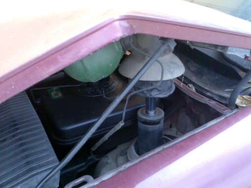

Recovered Xantia strut tops, if originals, likely to be in bad shape, apparently. Unlike the XM type (which were of thicker base steel, and protected by paint, which showed up rust easily on underside inspection), the Xantia types had a thin continuation of their 'rubber' covering the base plate steel. This actually traps moisture under the rubber, both hiding and accelerating baseplate rusting. Rusted enough, the polymer parts company from the steel baseplate, and pops through - as in the photo above.
Given this, it is unlikely that a cheap donor car would provide a good pair of tops.
