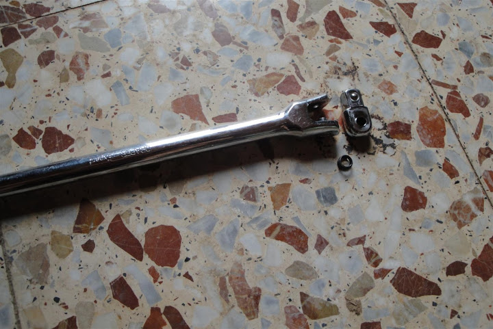

Just slackend the LH hub nut no probs. Then thought I'd slacken the RH one too just in case i decided to take the RH drive shaft out completey- but it wont budge!! the breaker bar is just over 1M long, but it's starting to warp- Any suggestions?

Mmm and then this happened:

Get a bigger one.... You can try putting the strain on the nut and then belting the back of the breaker bar in line with the nut, this often shocks the nut free. As you have found out, they can be tiiiiiight!!

I've had the same happen Larry! On an identical bar...lazza wrote:Mmm and then this happened:
As Richard says, get a bigger one

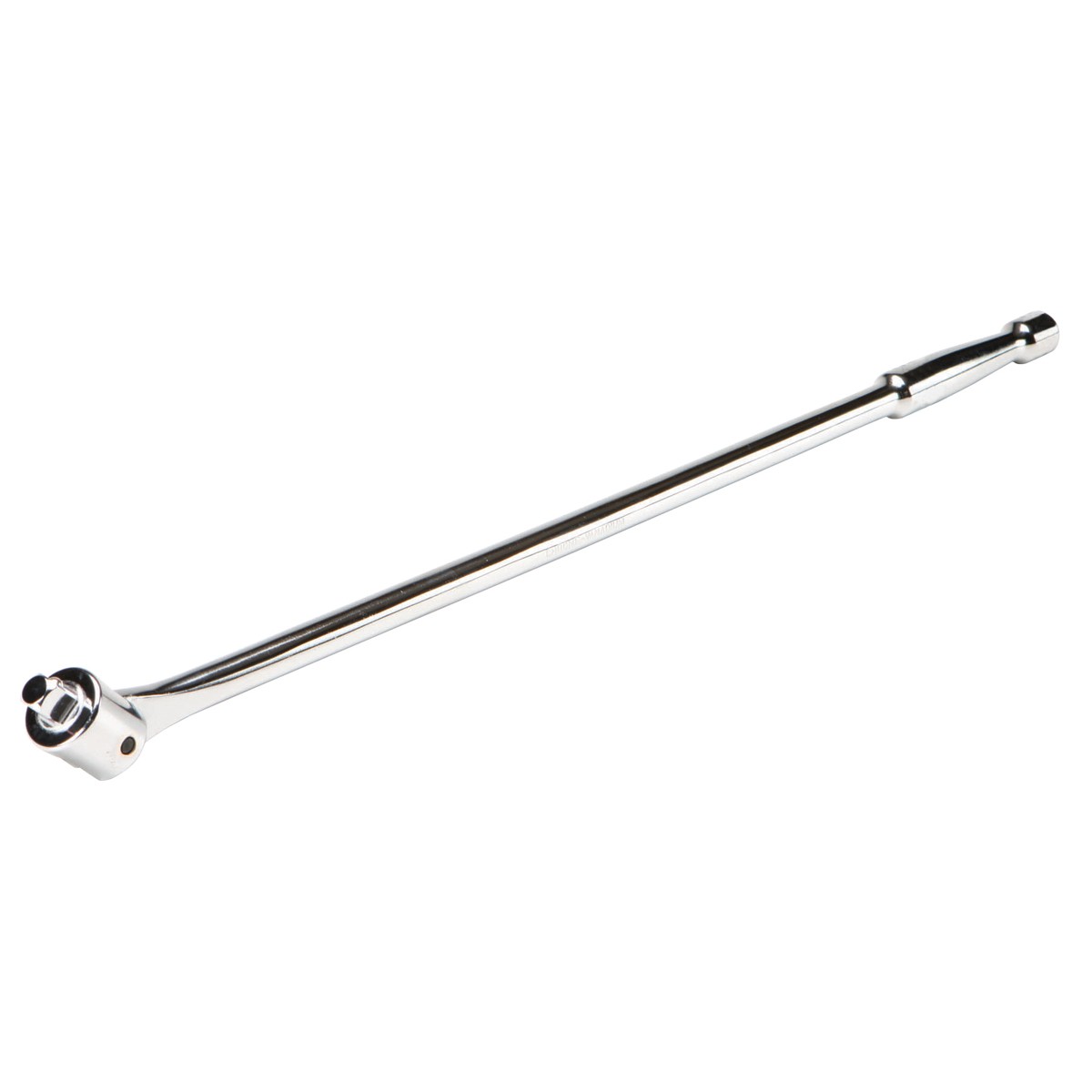

One that does not have a forked head will be much better Larry, the fork is a real weak point...

any pics or links for ones without a forked head? all the ones i can find seem to be forked

Something like this will be much better Larry, still forked in a way but in the opposite sense...

Mine is like that. It can take, er, a lot of abuse!!

1/2inch breaker bars are not suitable for this job. I always use a 3/4 drive t-bar and 3/4 drive socket. You can put a metal tube (jack handle or scaffold pole) over the end and stand on it. Worked for me on many, many hub nuts.
