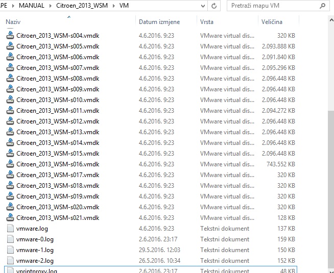

vborovic wrote:
leocitroen wrote:I am very satisfied with the material from emanualonline, 18,5GB for c5 .. 14€
Complete backup of citroen.service.com I think.
That can't be right ... the entire official Citroen Service Backup as of 2013 was 14 GB in electronics diagrams, and slightly over 9 GB for the service documentation ... for all the models starting from AX/ZX and similar generation cars up till DS5

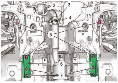

Remove:
  • The (2) bolt
  • The nut (3)
  • The clip (4)

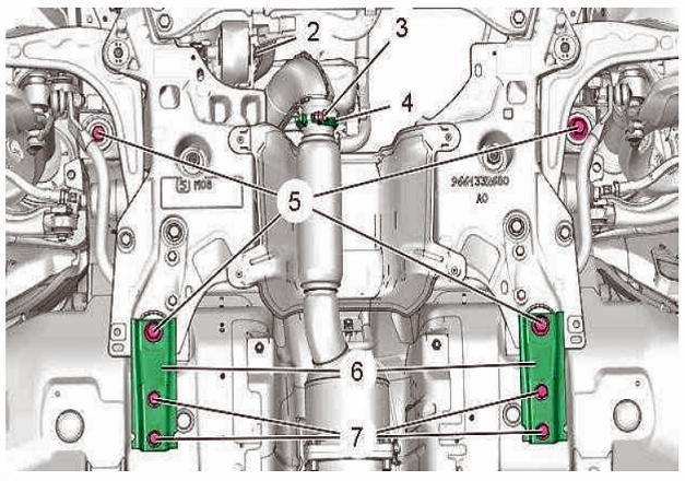

Position a lifting tool under the front subframe.
Remove:
  • The bolts (7)
  • The bolts (5)
  • The yokes (6)
Remove this front subframe several centimetres from the body.
N.B. : Leave the lifting tool under the front subframe.

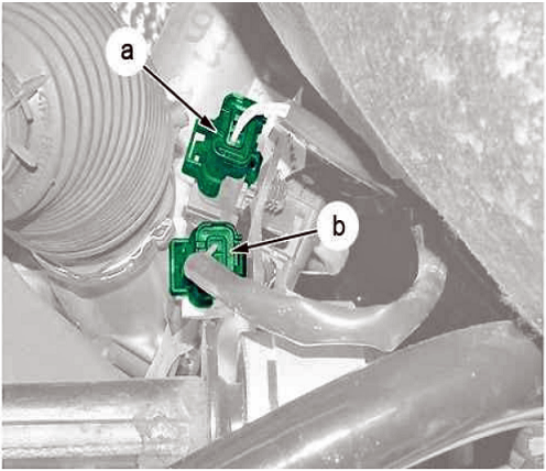

Unplug:
  • The connector (at "a")
  • The connector (at "b") (according to equipment)

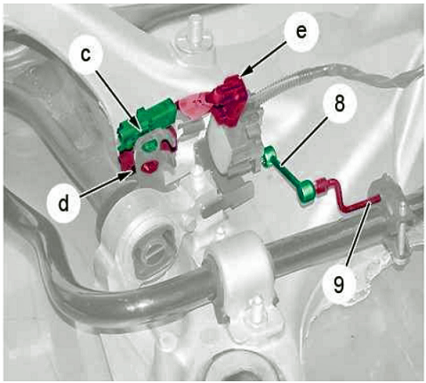

Unclip:
  • The connector (at "c")
  • The connector (at "d") (according to equipment)
  • The connector (at "e")
Uncouple the rod (8) from the lever (9).

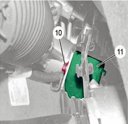

Remove the bolt (10).
Remove the front height sensor (11) through the wheel arch.
Blank

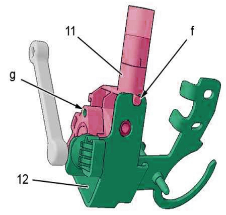

Peg: The height sensor (at "g") ; Using a TORX socket wrench 25.
Refit the front to fight sensor (11) to the support (12).
N.B.: Position the lug "f" on the support (12).
Hold the height sensor (11) in position.
Refit bolt (10); Tighten to 0,4 ± 0,1 daN.m.

Refit:
  • The yokes (6)
  • The bolts (7); Tighten to 10 ± 1 daN.m
  • The bolts (5); Tighten to 14 ± 1,4 daN.m
  • The clip (4)
  • The nut (3); Tighten to 2,5 ± 0,3 daN.m
  • The (2) bolt; Tighten to 6 ± 0,6 daN.m
Pull the lifting tool from under the front subframe.
