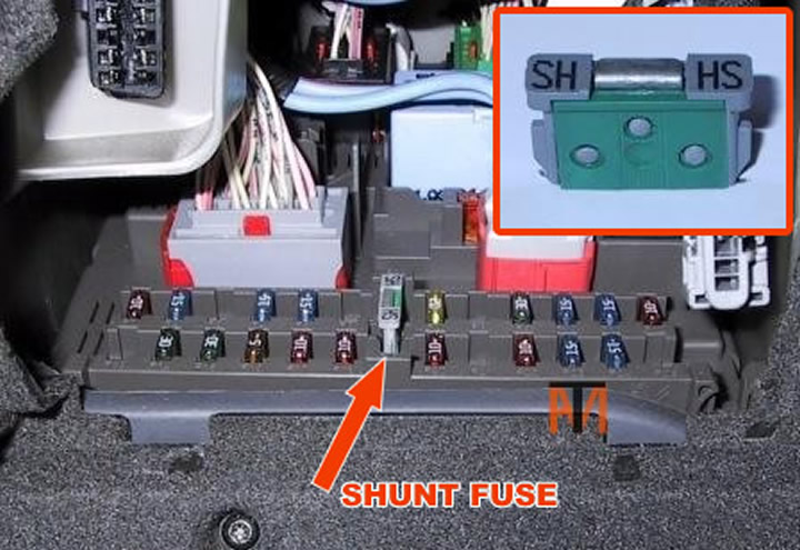

Going back to this problem my handbook doesn’t show the shunt, how do I identify it?

The following link takes you to a diagram for a 2008 C5 interior fuse box. The SHUNT is marked as SH;
http://www.autogenius.info/wp-content/u ... ynka-c.jpg
If your were to do a Google search for "Citroen C5 interior fuse box XXXX" with the XXXX being the year you should get images that are better suited for your C5.

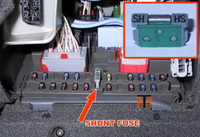

wheeler
- Posts: 7931
- Joined: 21 Sep 2002, 19:07
- x 1055
Re: C5 interior lights
The OP has said its a 2004 meaning it will be a mk1. This also means that battery condition doesn't affect economy mode, its purely a timer.
I reckon this is either one of 2 things, The shunt is in the wrong position or the BSI is in showroom mode, you would need Lexia or Diagbox to change this function. They can be set like this for (funnily enough) being in the showroom so when people are constantly opening & closing the doors to have a nosey the interior lights don't keep coming on & flattening the battery.
The shunt is in the interior fusebox, it looks slightly different from the other fuses & has SH marked on it.
Your fusebox/BSI may look a bit different to this but it gives you an idea. Some can be fitted in 2 different positions.
This is of course assuming ALL the fuses are good.

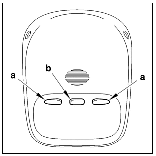

Ok, so just to be clear:
If you have the trim level with the map reading lights, you basically have three buttons as per diagram below and ditto in the rear.
So 'A' is the map reading spots - and these will ONLY power on with the engine running / ignition on.
'B' is the interior lights. The toggle settings are wither permanently on or only on when the doors are opened.
So you have confirmed these are working with the engine on, so that rules out the wiring.
Now I can't remember exactly - but many moons ago I do remember having a similar issue come to think of it.
I'm not sure, but I think I had to get in the car, open the door and press button 'B', then shut the door - or something like that to get it to come on or off when the doors were opened. It was toggling this option with the door open that seemed to fix it for me, but is was years ago now, but may be worth a shot. And if it doesn't work - try again with the ignition on.

^^ Had a similar experience after the kids had been away in the car and fiddled with everything, thought they had blown a bulb initially but then realised the rear light was the same.
MikeT
- Posts: 4808
- Joined: 11 Jun 2007, 16:17
- x 232
When I first got my car I thought the interior light was on permanently at one point so pushed button b to turn it off. Next time I went to the car it never came on again until I pushed the button then normal auto/courtesy function was restored.

I’ve tried holding the on button on whilst foot open to no avail. I’m sure it’s this ‘economy’ setting which is the problem. Someone said that the shunt in the glovebox fuse block should be changed position but the alternative doesn’t fit
- x 6945
Ignore that about the shunt - that is for 'Show Room' mode setting and involves connecting a special electrical harness to the car and removing certain fuses, connecting up the harness and replacing other fuses - it's really for supplying the car with external power to maintain the lights, dash displays and other functions without allowing the car to be started and also requires the diagnostic tool to programme. This setting won't be the cause.
