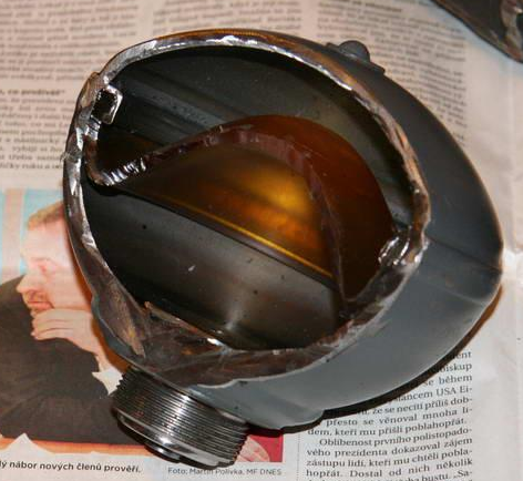

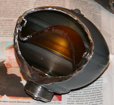

GiveMeABreak wrote:Don't want to go too off topic here, but looking into this Sphere issue - I was interested to find a couple of links to pictures of inside the Saucer spheres - in this case comparing an IFHS Sphere with a Citroen Original Sphere.
Inside an IFHS Sphere
Inside a Citroen Original
Image[/URL]
The point being that according to the C6 guys the IFHS, MONROE and SUPPLEX saucer spheres are the same inside as the old green LHM spheres in terms of membranes and don't last as long as they still suffer with the nitrogen slowly escaping.
The Citroen genuine spheres have the newer membranes in which seal better, reducing nitrogen seepage and allows Citroen to guarantee them for 5 years / 200k Km.
Guess I know which ones I'll be replacing mine with!
The Citroen sphere has a 3 layer membrane, the so called long life types which were first introduced on the front suspension of some Xantia's - the middle layer is impermeable to gas while the layers to either side of that provide mechanical strength. In a conventional sphere there is only one layer that provides both gas impermeability and strength - but the material is far more porous so it leaks much faster. As far as I know none of the after market sphere suppliers supply the 3 layer long life spheres, that includes Xantia's too.
And back to the topic - no extra damping holes inside the sphere as far as I can see.
You wouldn't see any damping holes in either of those two pictures - the damper valve is inside the neck of the sphere, not the body, and you're looking at the damper valve side on. The damper is contained entirely in the neck of the sphere and is only about 10mm thick.

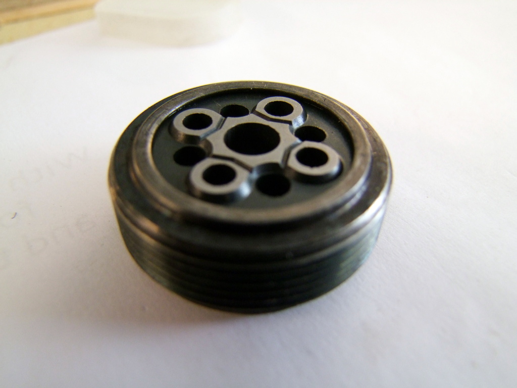

I hope I can extract a leaf valve tomorrow, not least to measure the holes it reveals.

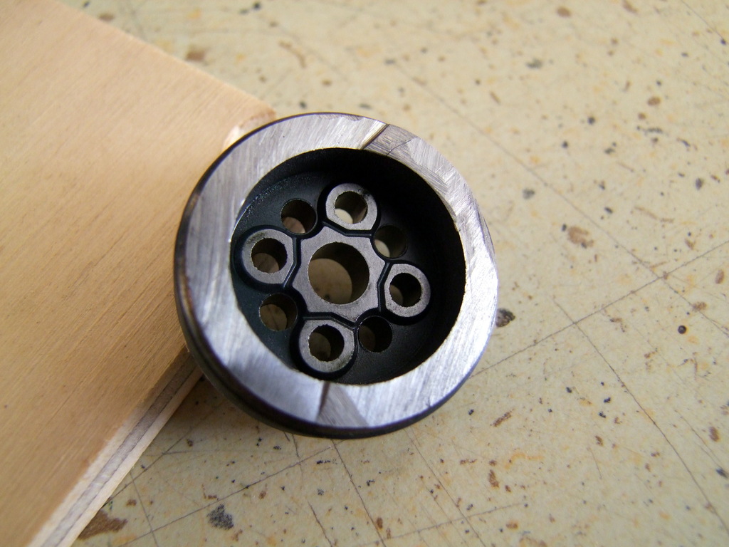

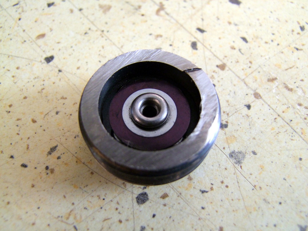

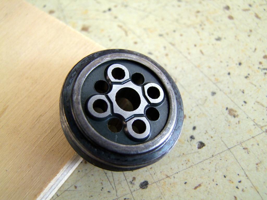

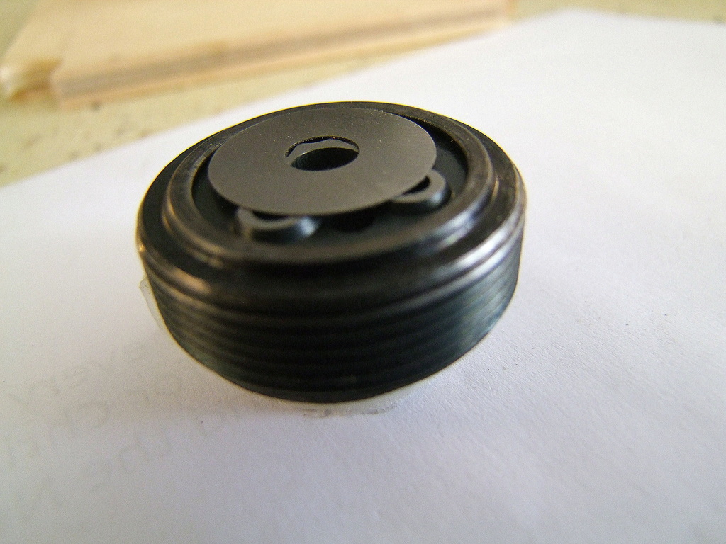

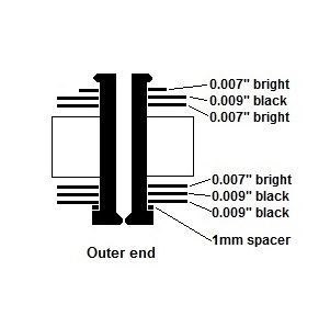

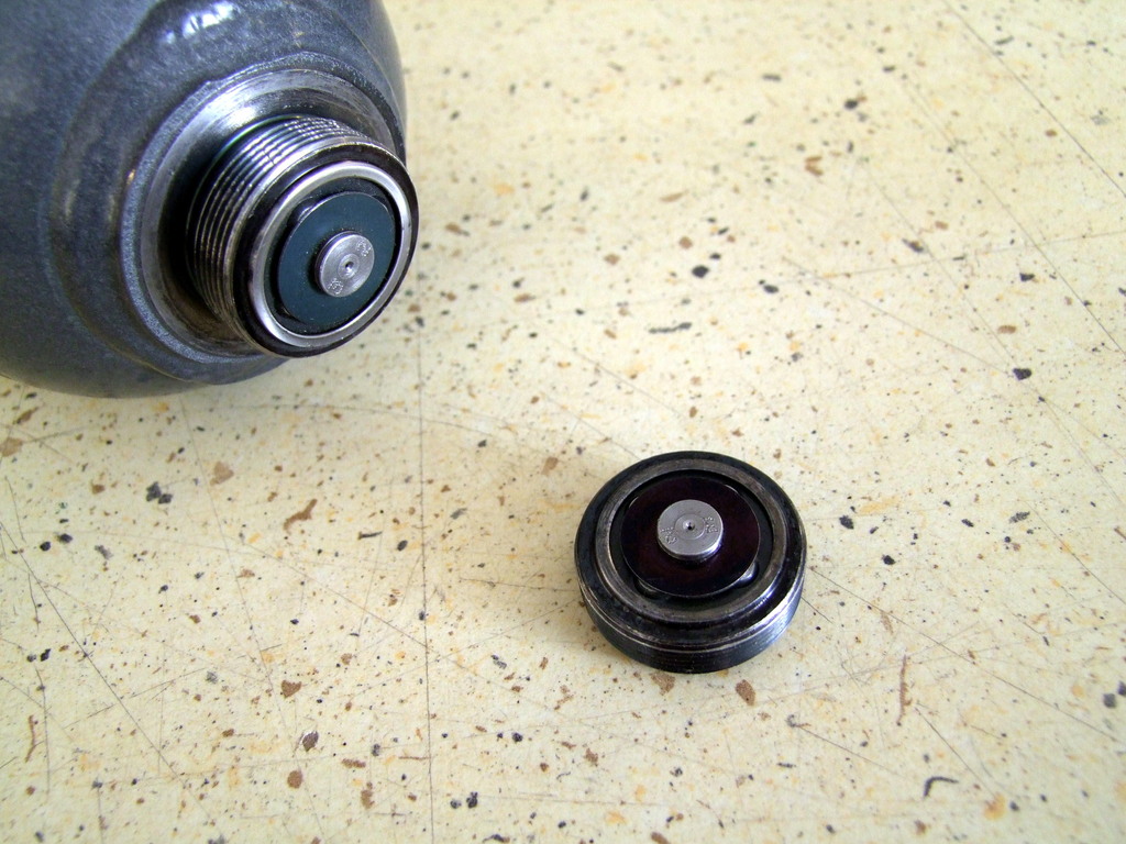

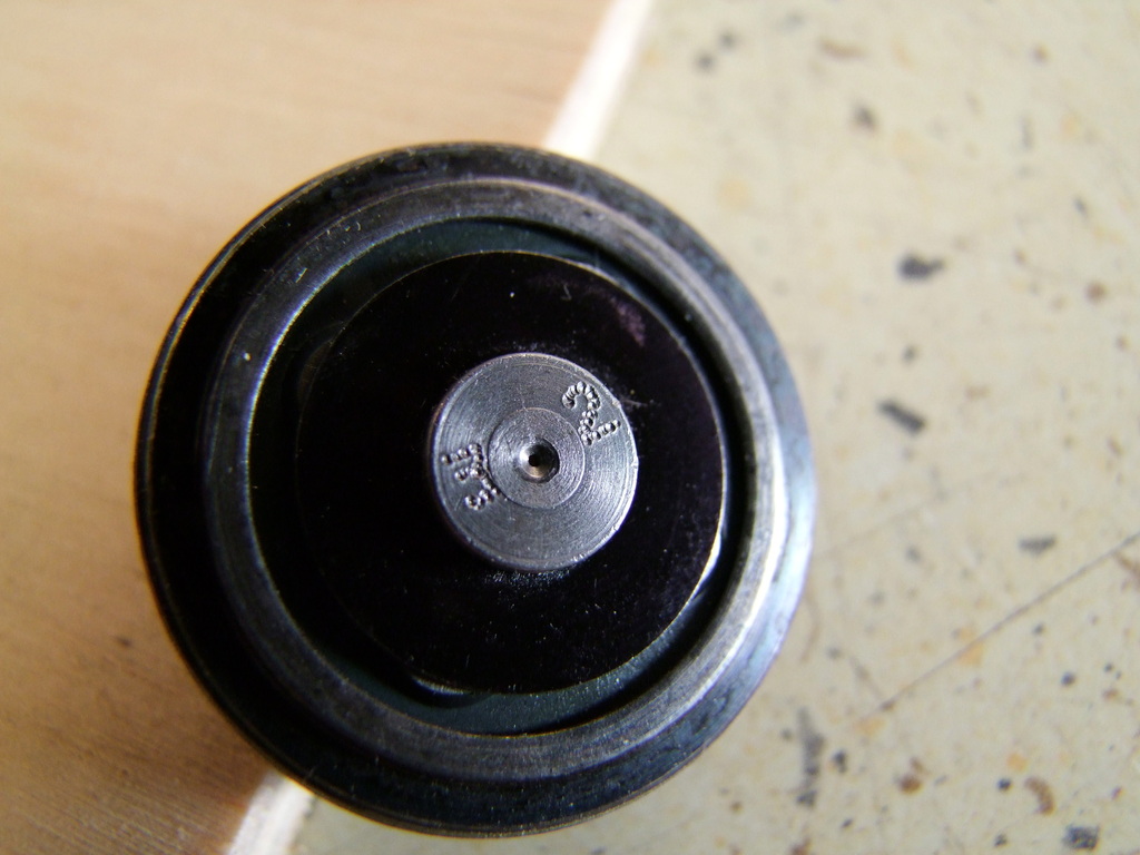

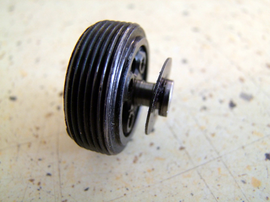

Spheres and Hydro-pneumatic are a special interest of mine. Many years ago when me and Dad both had GS's we had a shortage of GS spheres (which are identical in construction to modern Xantia spheres - and were/are very expensive in NZ) but had a home made re-gassing rig and a few DS spheres kicking about. DS sphere's have removable damper valves of a different design to modern spheres - they're functionally equivalent but constructed quite differently.
Instead of a cylinder with washers riveted to either side in the middle with a centre bypass hole down the middle of the rivet, the whole stack is simply bolted together with a bolt through the middle, and also bolted into the sphere neck. This means that the damper valve can be easily removed from the sphere and disassembled, washers removed and different numbers of washers fitted.
The bypass hole is near the edge of the disc instead of through the middle (not that it matters) and instead of the leaf valve holes being bored straight through with a depression in the middle cylinder/disc to allow oil in, the middle disc is flat on both sides and the through holes are all drilled on an angle so that one end of the hole is inside the diameter of the washer and the other end is outside the diameter of the washer - to give the same one way effect. Alternative holes are drilled on opposing angles.
The neat thing about those DS spheres is you can remove the damper valve in minutes and disassemble it, change the washer configuration, (thus changing the damping of the leaf valves) bolt it back together and put it back on the car. On a modern sphere the damper valve assembly is an interference fit inside the sphere neck - they probably fit them in the factory by cooling the damper valve then pushing it in. Getting it out without destroying the sphere and using a press could be challenging. If you want to have a look at one a bit more easily find an old Hydractive 2 control block from a Xantia or XM - they have two damper valves the same as spheres inside and they are very easy to remove with just one socket! (Just remove the two plugs where the large steel pipes normally go and they fall out... :) )
Anyway, we experimented with gas pressure and washer stack configuration of the DS spheres on the front of Dad's GS, so I learnt a lot from that. Even though DS sphere's are a lot larger CC than GS spheres (500cc vs 400cc I think) you can compensate for that by filling them to a lower gas pressure to get the same effective spring rate. If you fill them to the "normal" GS sphere pressure the ride is much too soft.
Likewise we experimented with the number and thickness of washers (multiple different thickness's were available/used and fitted much like stacking shims in a bearing to get the correct thickness) and initially we had too many on which made the ride rather firm indeed. I remember the first test drive with the DS sphere's the ride was actually very firm at the front but very stable feeling - not unlike Hydractive 2 in hard mode. We had to remove some washers to get softer damping to get a more normal GS like ride but with the right thickness of washers we were able to achieve that. :)
A few years later on a Series 1 CX we had fitted some new front spheres and found the damping at the front quite a bit too floaty. It turns out that Series 1 CX's have smaller suspension pistons at the front than Series 2 CX's, so the gas pressures and damper valves for S1 and S2 CX's are different to compensate for this. Unfortunately by this time (1998) Series 1 CX spheres were no longer available, at least in NZ and Citroen only supplied one size fits all for CX's! #-o This time we experimented with the damper hole since the damper could not be disassembled like the DS spheres. I don't remember exactly what the original hole was but I think it was 1.65mm.
To change the hole size we simply soldered the hole closed then drilled it back out with precision drill bits. Initially we tried 1.2mm - this gave really good damping and nice feeling handling with no floatiness at all, but the ride was too firm and lost its CX charm. Eventually we settled on 1.4mm I think - which was enough to remove the floatiness and overshoot but still maintain a comfortable wafting ride. It was an almost perfect balance. Yep, just reducing 1.65mm to 1.4mm was all it took...
Many years later I experimented with damping adjustments on my Hydractive 2 Xantia - in particular I found the ride in soft mode a wee bit too much on the "floaty" side for my liking, so I removed the damper valves from the Hydractive control blocks (which control the slow movement damping in soft mode) and reduced their bypass holes from 1.1mm to 0.9mm. (Using the same solder then drill technique) That doesn't sound like much but it was enough to take the soft mode from a bit floaty with a bit of overshoot to almost perfect critical damping where the car returns to a steady state after an impact as quickly as possible but without overshoot. I liked that balance a lot.

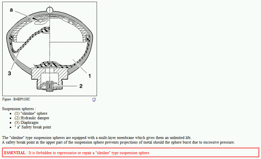

I've just dug this up which shows a slightly better view of the internals of a slimline sphere - specifically the valve area - in case you didn't particularly want to start hacking one to bits in your vice! :-D
Oh, and again, note the 'umlimited life' claim here again.
Mandrake
Posts: 8692
Joined: 10 Apr 2005, 17:23
x 695
Re: Sphere specs
Unread post by Mandrake »
Thanks for the picture - very handy :) You can see that the damper valve is right at the base of the sphere neck - there is quite an empty region above it. You can kind of make out the washer stack on either side of the damper too.
"Unlimited" is a bold claim indeed, but in a way they're right. Conventional spheres progressively lose gas at a steady rate and apart from ceasing to ride properly when they get too low in gas they eventually puncture and fail because of the loss of gas if you don't top them up in time.
The long life types do not leak gas - I have seen long life front spheres on Xantia's (which use the same 3 layer diaphragm principle and material) which measure exactly at their original 45 bars at over 10 years old and 100k miles and still work perfectly, no loss in performance or ride at all.
However they can eventually fail due to fatigue of the diaphragm - when that happens they lose their pressure very quickly indeed. So the multi layer membranes effectively change spheres from a "wear and tear" service item like a brake pad, which is expected to wear out at a certain rate and need replacing after x number of miles or years, to a part that might potentially fail at random within a 10-20 year life time, but probably won't.
From what I've seen you can expect these type of spheres to last at least 10 years without any loss in performance, and probably a lot more.

x 6945
Re: Sphere specs
I thought it might be useful (or not!) to see what's inside. Why is it that they expressly 'forbid' re-pressurising of the slimline spheres then? Does anyone know why they have specifically mentioned this type of sphere?

I believe the reason for the advice against re-pressurising the multilayer spheres is that because they don't leak pressure at all under normal conditions, a big loss in pressure that would warrant re-gassing is a sure sign that the diaphragm (or at least one of its 3 layers) is cracked/fractured and is about to fail. Thus re-gassing the sphere is almost certain to leave you will a sphere that will fail completely in a short time.
The few spheres of this type that I've heard of failing failed completely and very quickly after the first sign of pressure loss. (Just a few weeks)
While with a conventional sphere pressure loss is expected and if caught and re-gassed before it goes below about 50% can be safely re-gassed and have its life extended.
Simon

Re: Sphere specs
That makes sense Simon - I just saw the huge red warning and the words 'forbidden' and it conjours up images of cranking open the top cylinder nut then 'bang' and it's strawberry jam on the wall behind you!
x 1746
Re: Sphere specs
That's a really helpful cross-sectional diagram, Marc, showing the exact layout of parts for the compact sphere.
As promised, I did get to work on an XM-type sphere, to extract and examine the leaf-valve...
^ First, sphere neck sliced off.
^ Central damper drilling, seemingly marked 32 (not 2 and E, as I thought before), and marked with what appears to be a manually applied centrepunch. Very odd. Note the countersinking for the drilling, added to later spheres, to improve fluid flow.
^ The interior end of the valve, with peened-over central sleeve, which holds the valve parts together. The peening was simply drilled off.
^ This then allows the central sleeve, containing damper drilling, to be pushed out (it's a very snug fit), freeing up the washers on both sides.
^ Leaf washer positioning, with apologies for the mixed units. Interesting to note that the individual washers have extremely tiny amounts of flex.
>>> Now edited, to show correct 3.5mm central drilling, narrowing to countersunk 0.7mm damping aperture.
^^ Outer and inner views of the damper body. Large central drilling for the central sleeve is 7mm diameter, and all other holes are 4mm, parallel sided. Note the raised and machined surface for every alternate hole; on this surface seats the leaf washer. This provides two one-way and pressure-sensitive valves, one in and one out.
^ Side views showing raised seats, and clearance between the flex-washer and the lower set of holes.
This is a part I haven't dismembered before, and it has provided quite an insight into a component which is crucial to the Citroen ride.

Great pictures Chris - a round of virtual applause is due. It's hard to imagine all those components inside the space of the neck! =D>

Very interesting. Can you tell anything about the different materials of the washers? hardness, springiness, flatness etc?
x 1746
Re: Sphere specs
No, but I will take a closer look, and try to assess the flexibility.
