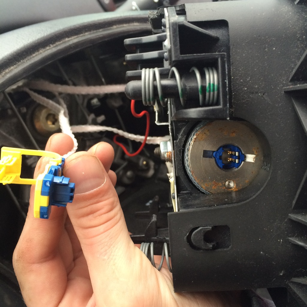

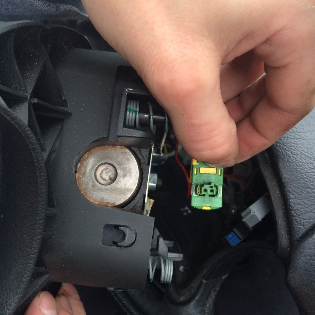

The airbag was removed and when you turn it upside down to inspect it, on one side the there is a hole with a blue socket, that a plug fits in but, at the opposite side there is a plug that was pushed into the same type of hole but there is no socket in that hole. Plug sits kind of loosely in that hole, is this normal?
It just doesn't seem right but what do I know
I have searched online for side views of airbag but no luck.
Again, any ideas or replies would be appreciated.
I have now ruled the ECU out and have another question if I may?

Tam - a few pics might help us see the problem - 'sockets and holes' - a bit confusing to understand what you're trying to describe

As you can see, the left(Blue) has a blue socket to put the plug in but the right(Green) does not. It simply sat in that hole

Well one is definitely the airbag plug. There are several plugs - horn, airbag, audio controls etc - all depends on kit. I can't tell you which is which though Tam. The driver and passenger front airbags generally have a 2 stage igniter depending on the severity of the impact. detected by the sensors, which informs the airbag ECU, which determines whether the igniters should both discharge together resulting in a quicker more forceful impact or whether a single igniter fires in a less severe impact, with the second igniter following shortly afterwards (to ensure it does not get triggered later if emergency services are in attendance for example). I'll have to do some digging!

As ever Marc, much appreciated, just find it strange that the green plug doesn't have a socket to plug into! As I said it was just sitting in that hole where I imagine a socket should be. Without seeing side views of other airbags..i'm stumped.......not hard I know
