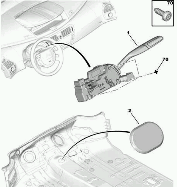

- x 6954
Re: C4 EGS Gear Selector Coherence Fault
Basically it is item 1 in the diagram:
The procedure to change it seems pretty straight forward - but when the gear selector is replaced, the gear control counter need needs to be reset to zero using a Lexia / Diagbox.
Counters....? sounds a bit ominous, I hope it's not one of those 'when it reaches a 1000, time for a new one'!
Looking on the bay, there is one here for £30 - they list the part as 96811352XT - but don't list the PSA number. I've checked at another online store in Germany and they have the same part number, so looks ok.

Is this a Picasso - as that part no only comes back against Picasso. It seems to be pretty easy - not even necessary to remove the wheel. It does say diag session required after to re-set the gear change counter. Part is just over £200, and book time <1 hour to £370 fitted seems a bit steep. I'm sure you could get a 2nd hand one and fit it.
