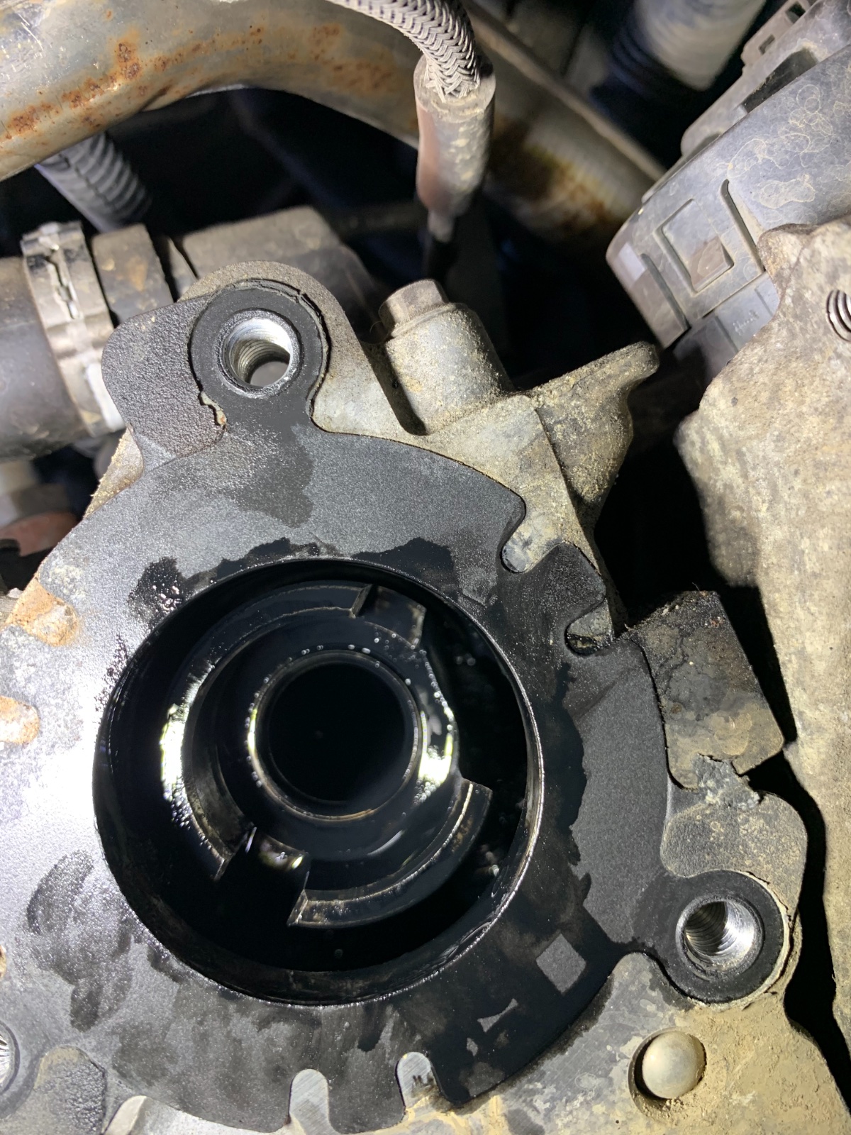

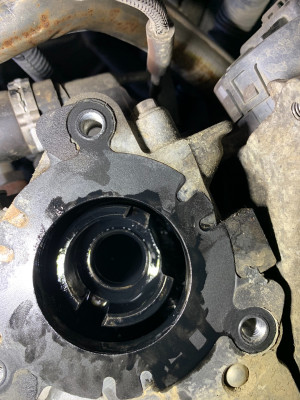

I’m having the same problem with my 2007 Citroen dispatch 2.0 hdi, turns out the rattling is caused by the end of the camshaft breaking off with runs the hp pump and causes a rattle, currently the van is in the garage with 2 stuck injectors in the head so fingers cross after soaking they will come out in order to change the camshaft
