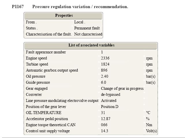

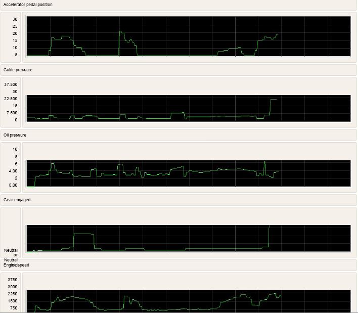

What I observed that previously before last oil change I was receiving 2 errors p0006(pressure regulation) and p0070(converter lock-up)
Now I am receiving p1167 (pressure regulation) only.
Here some pix
Tested the car this morning
Temp was about 15c
When cold it move forward but on reverse very weak
Tried to drive for some time
No slippage but error very frequently and gear go to limp mode
Here some pix
