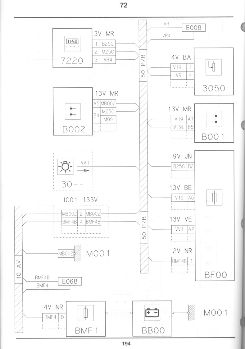

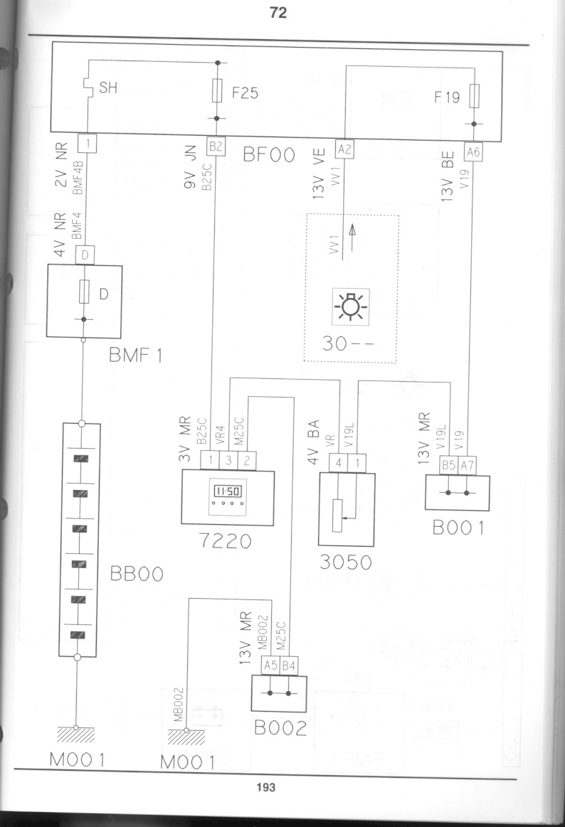

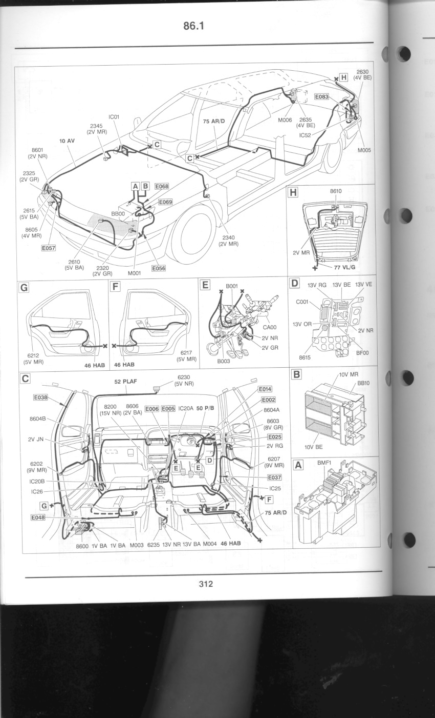

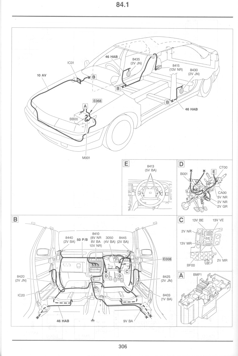

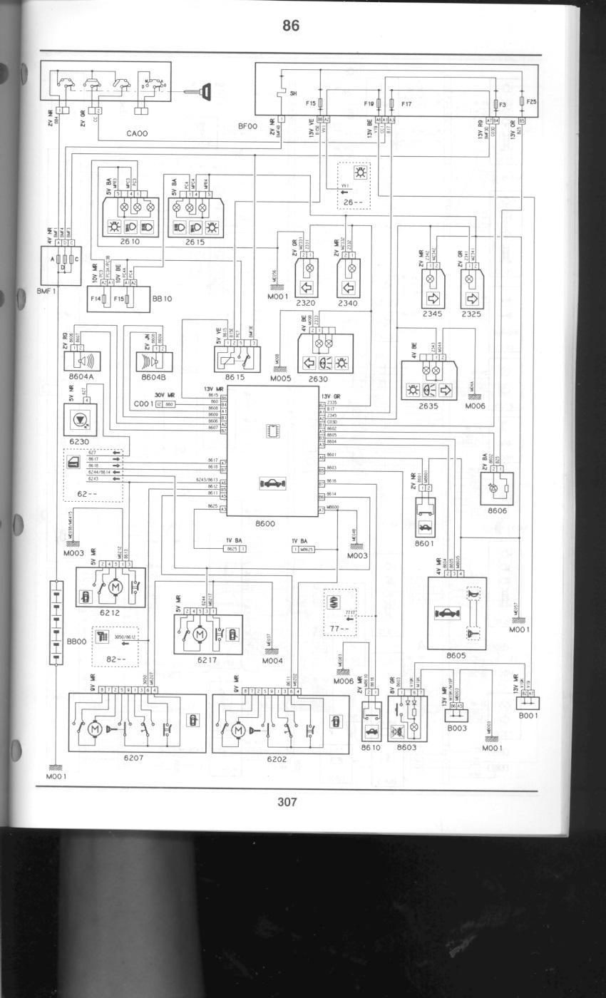

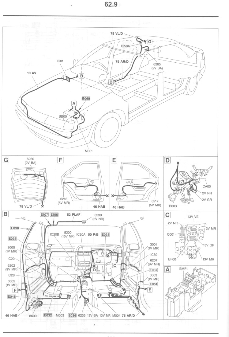

Re: S1 Xantia V6 - no start, no central locking

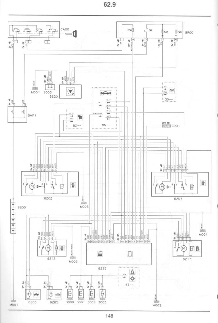

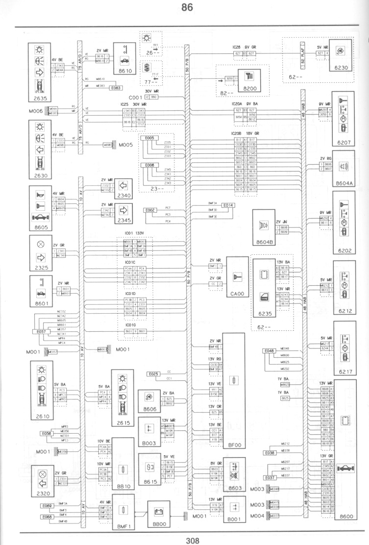

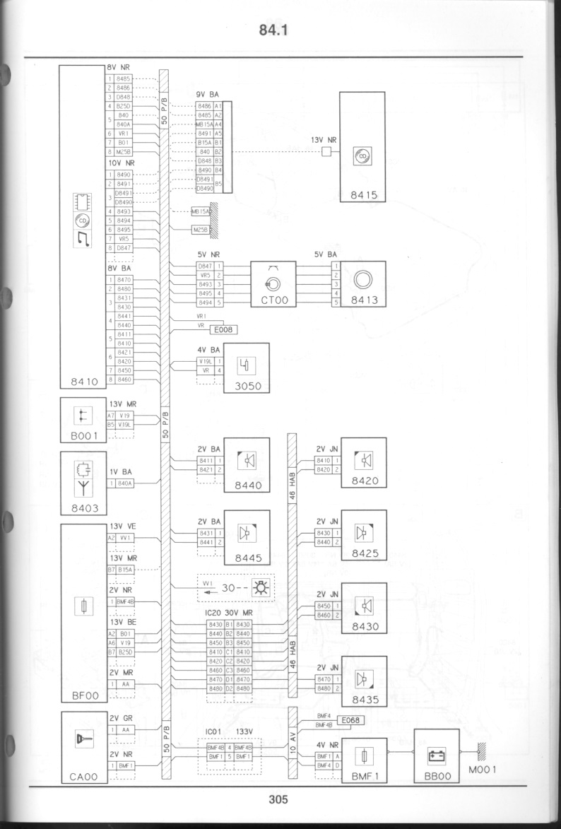

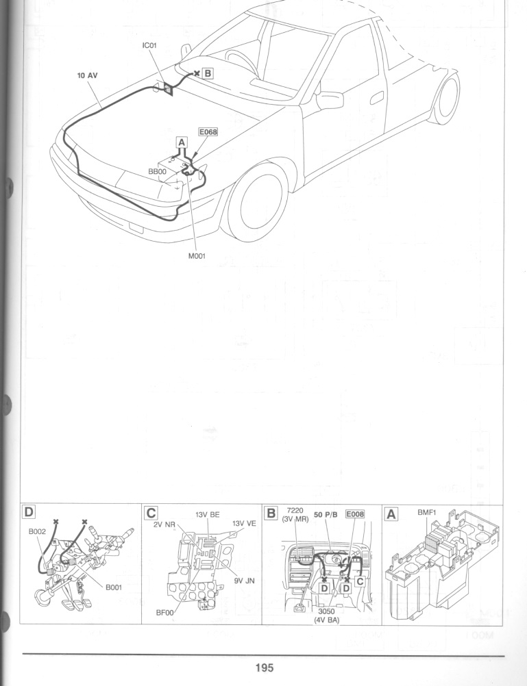

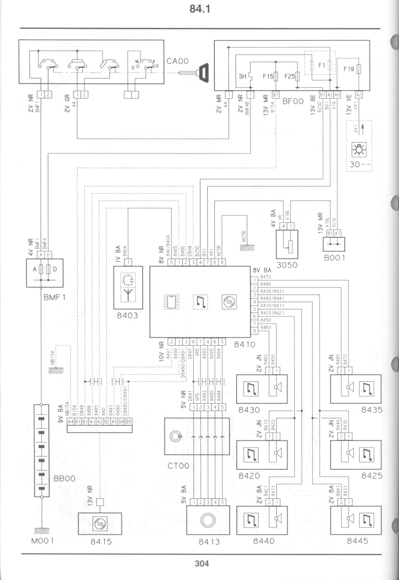

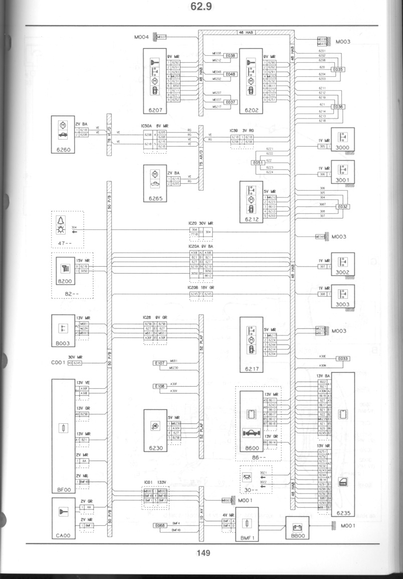

Simon,
Diagrams needed...
Keypad Locations
Deadlocking Cct
Deadlocking Harnesses
Deadlocking Locations
Alarm Cct
Alarm Harnesses
Alarm Locations
Clock Cct
Clock Harnesses
Clock Locations
Wireless Cct
Wireless Harnesses
Wireless Locations
That's almost the whole book scanned now
Hope those do the trick Simon..
Diagrams needed...
Keypad Locations
Deadlocking Cct
Alarm Cct
Alarm Harnesses
Alarm Locations
Clock Cct
Clock Harnesses
Clock Locations
Wireless Cct
Wireless Harnesses
Wireless Locations
Mandrake
- Posts: 8692
- Joined: 10 Apr 2005, 17:23
- x 695
Jim you're a star
I'm armed with a big wad of print outs to take home with me...
You really ought to save a permanent copy of those somewhere and add it to the useful threads section!
Looking at the clock wiring I see a potential source of trouble already - B002 which is some sort of bus bar located near the pedals ??!
The circuit for the clock is really simple, so if measuring on the central locking ECU doesn't give any clues I think the B001 and B002 junctions will be my next port of call...
Also just noticed that F25 is shared between the clock, the radio, and the positive feed to the alarm LED! Bingo... (The alarm itself is powered through a different fuse, only the dash LED is powered through F25, and that LED is very weak) The ceiling infra-red receiver also seems to be powered by F25.
Who wants to bet that its a dry joint on the back of F25 in the fuse box...is the drivers fuse box difficult to get out to solder on the back side of it ?
