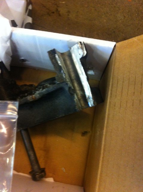

Ben 82 had quite a lot of trouble with his: http://www.frenchcarforum.co.uk/forum/v ... =3&t=52994
One of the old calipers came back from the garage looking like this:
