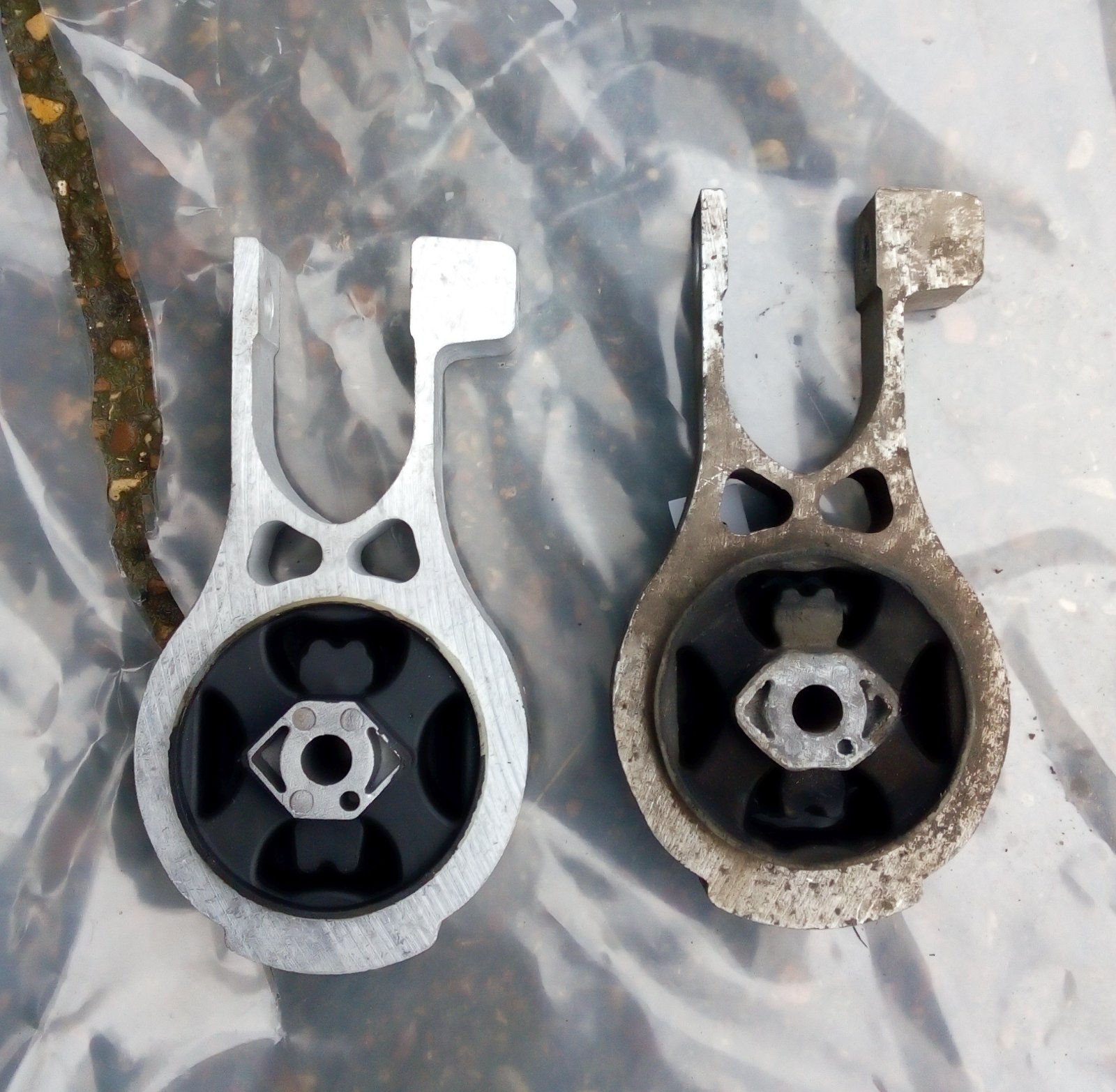

this completes the service, well except for the autobox oil, I job I fear for some reason.. I still don't know what oil I need
will have to look back through other posts..
the rubber was fractured, but it didn't really need replacing.. easy job to change though. £30 for the part

Re: C5 (X7) - Front lower suspension arm replacement.
That’s good! have you noticed a difference at all?
Thanks ED .. AW1 it shall be..
The clunking on braking went after the lower arm fitted .no other difference
