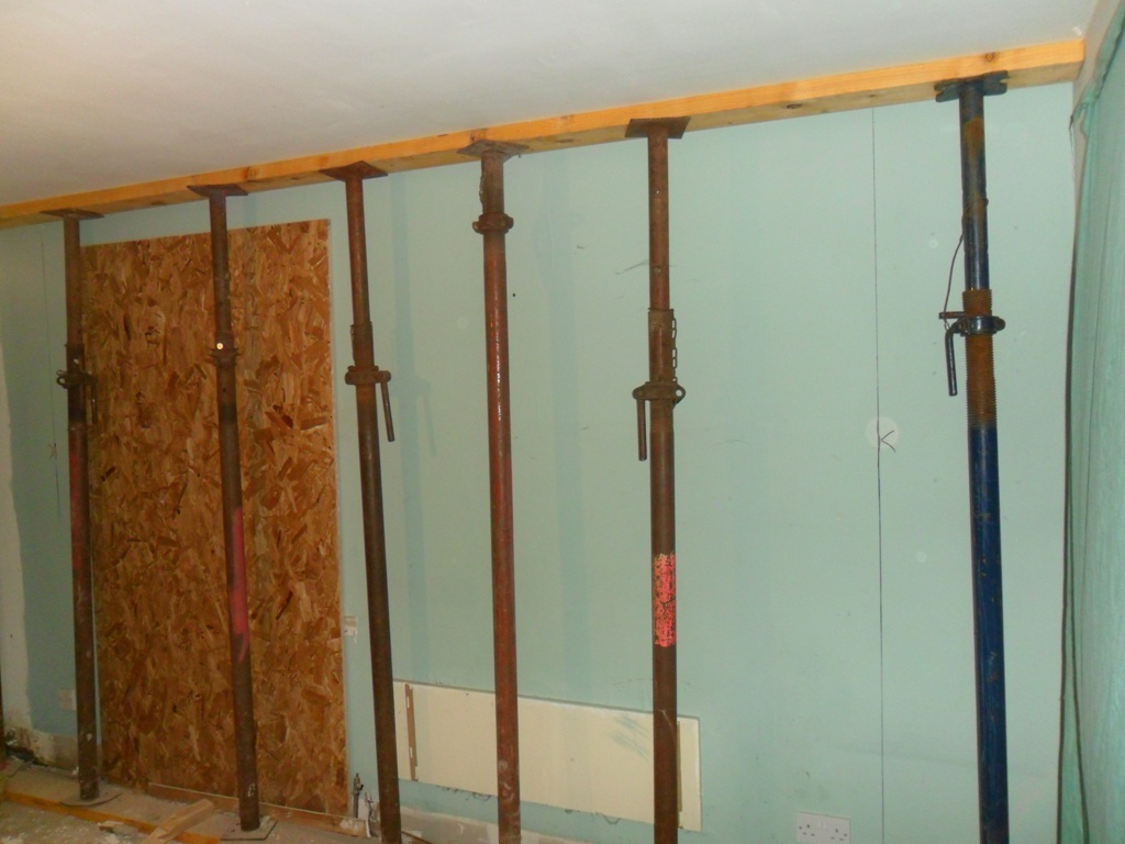

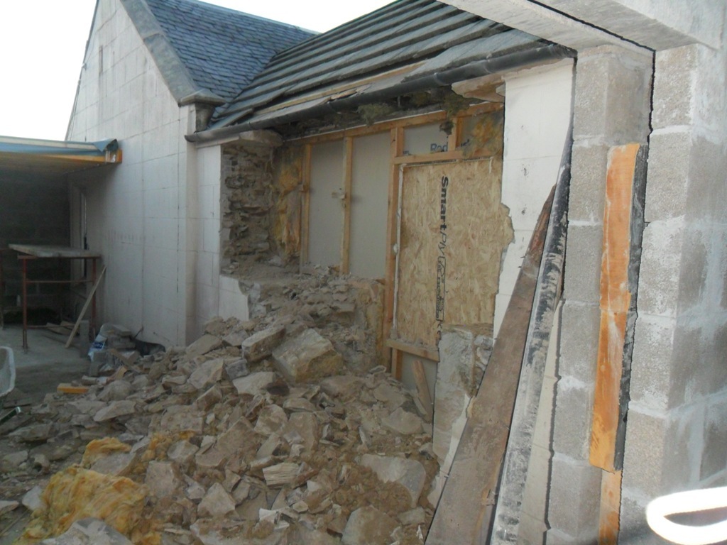

They never give trouble in the summer.... :lol:
At least you've still got walls though....
It's OK, it was intentional, got some supports on the other side!

Best comeback ever. :rofl2:
Mind you, if you had seen our kitchen or bathroom a few months ago... (still not finished, but getting there)
That's some mighty thick walls you've got there :shock: thicker than the walls in our 1930's bungalow which has pretty solid walls...
I bet you notice the cold coming through what's left!

@ Mandrake - the wall is about 500mm thick - pretty std for a 'solid' stone wall (if a few bits of stone held together by 160 year old lime mortar can be called solid!). It's pretty cool in there, but this is more to do with the hole he cut in the other end to allow fitment of a new window. It's surprising how effective a sheet is at keeping the heat in the living room!
