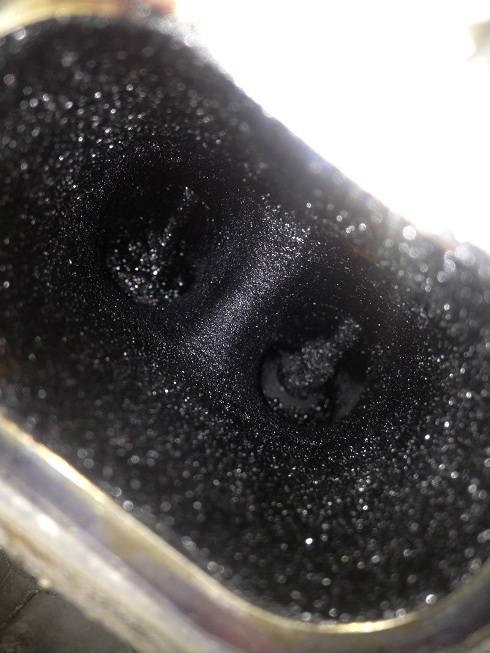

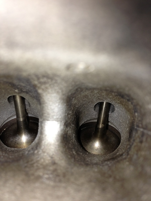

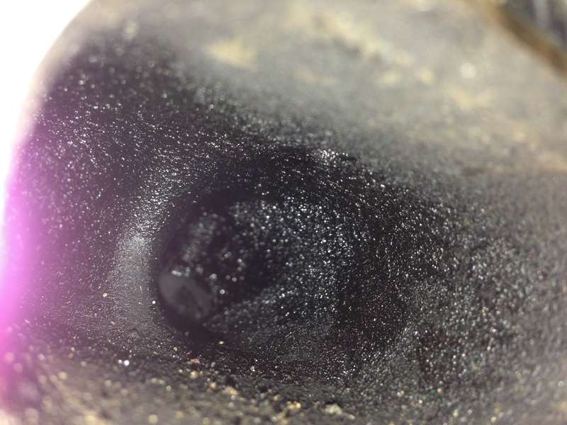

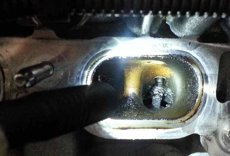

Here's a picture of a BMW mini inlet valve that is apparently "not that bad":
Here is one that's a lot worse:
Here's one after being "Walnut Blasted":
So, at the moment it's a lot better but still not right.

Bloody hell.. ive seen cleaner diesel engine valves then that.. and prv 24v valves cleaner too and there is a decade or two between the designs...

These pictures were taken using an inspection camera at 25k
