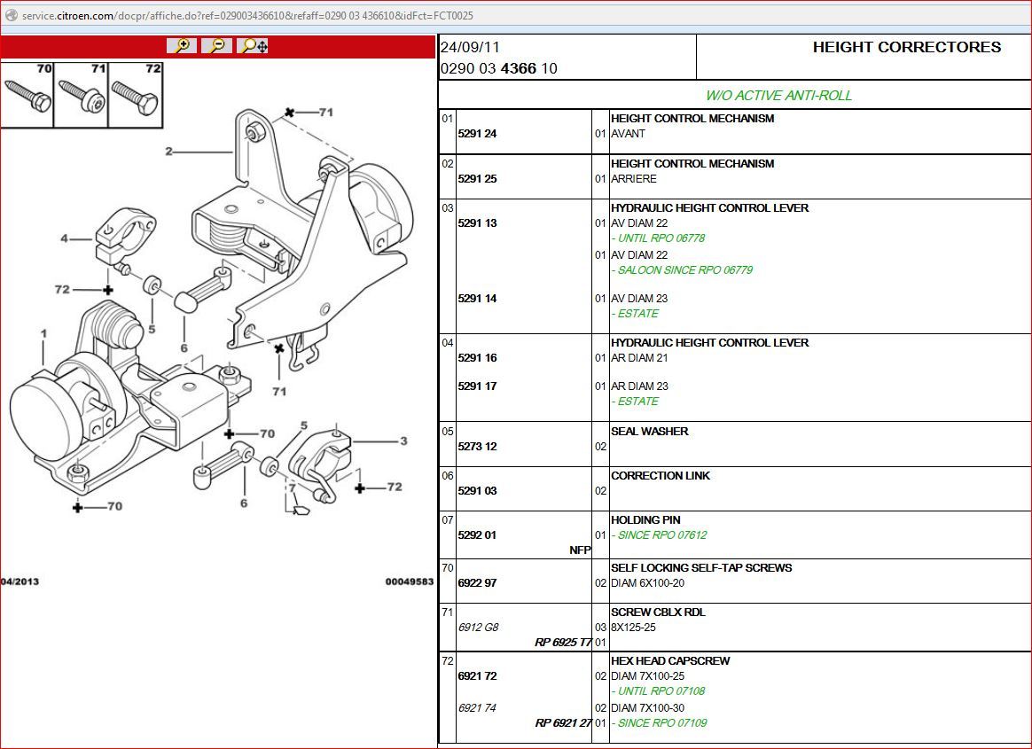

All this talk of ball joints etc, could someone supply some pictures of the front corrector removal? If I can see how it all comes out I might get the guts to do the job ... will take some pics of how the cr sits normally see what you guys think

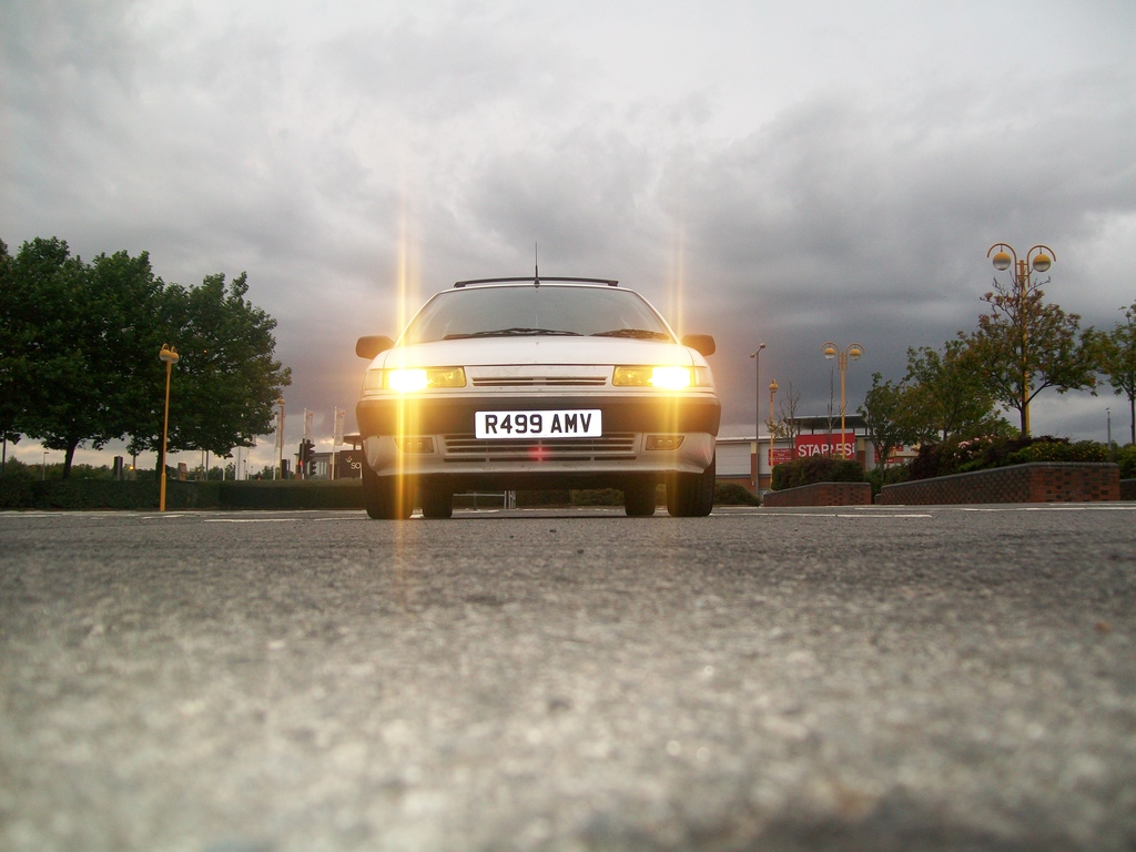

Front from floor level including yellow headlamps (and lots of dirt from recent trip to malham and lots of repair work going on)!

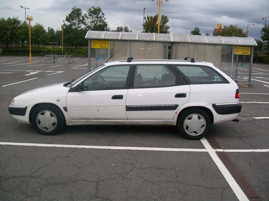

Drivers side, again lots of dirt (sorry about that) ... I think the back is high and the front is too low!

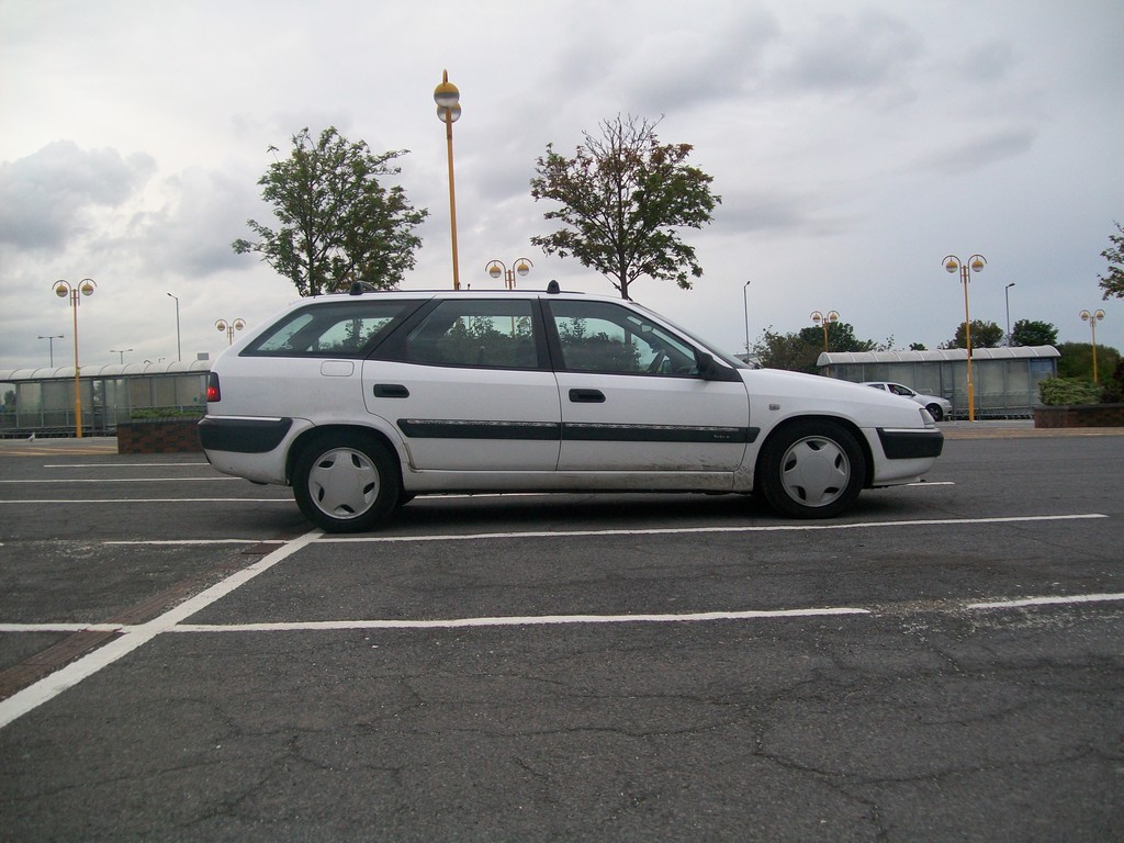

Passenger side after some urk pulled off the door trim and broke all the clips in the process :roll: really why do that??

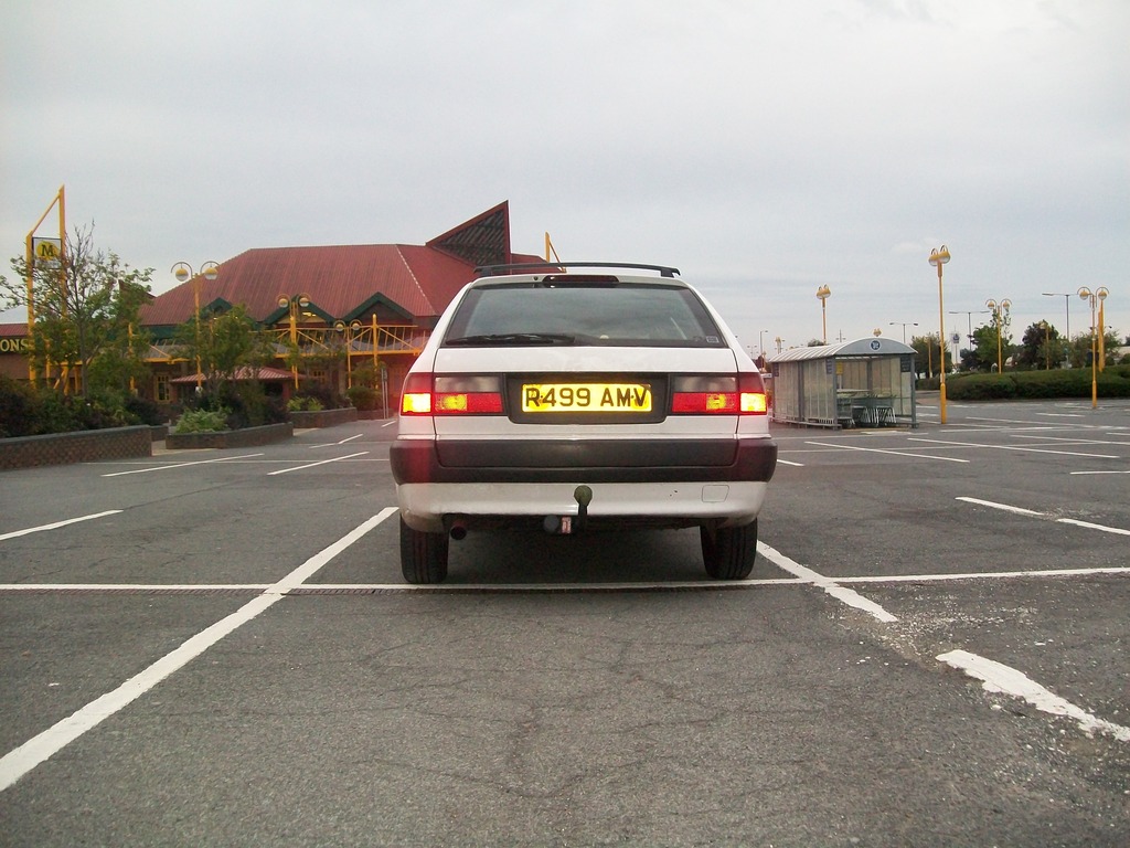

Straight on from the back ... I really think that it's sitting too high at the back, Also have straight pipe on at the moment until I have a better system made! This helps to stop the corrosive gasses from sitting under the back and rotting out the n/s wing (also makes it faster lol)

best bet is to get under and make sure this part is attached! Image
from what I can gather they are sacraficial, being plastic, so that if anything happens you won't break the corrector or the clamp on the ARB. The height control manually forces the car into certain heights, whereas in the driving position the right height is controlled by the linkage connected to the antiroll bars to make it self levelling. this is why it works when you select low/high but putting it back to the middle does nothing.
