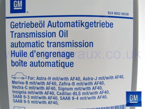

If it takes 3309 spec gearbox oil there are two alternatives to OE transmission oil, Mobil 1 do a fully synth 3309 and also Toyota type IV tranny oil is the same stuff. My Saab 9-5 took the same stuff and Saab wanted stupid money for GM branded oil.
09 C5 X7 2.0Hdi Exclusive in Perla Nera black (the best colour)
- Posts: 26424
Re: Can anyone help? C5 HDI X7 Auto gearbox hesitating!
Dont know what fluid Citroen recommend for the Aisin Warner 6-speed box.
Vauxhall/Saab specify the same stuff (part no 93165147) meeting the AW-1 spec.
This is available from AutoVaux at £7.45/litre inc VAT. Dont know shipping costs.
Granville do a fully Synthetic Dexron VI oil which specifies "on the tin" that it meets the AW1 spec (not many do). In general more expensive.
For TF-80SC (ie the AW 6-speed box) enthusiasts there are endless discussions on virtually all car forums which use the box in their vehicles. A lot of the discussions relate to what is the correct fluid to use..this one from a Volvo forum is typical
When I do eventually get round to doing the full flush change I know if I go my Auto Transmission Specialist they will use a semi-synthetic or fully synthetic oil, and I suspect that this was the case when my transmission was rebuilt. The "genuine" 93165147 stuff is mineral based, as it turns out cheaper now, and very probably not as good or long-lasting as the synthetic. Also my rebuilt box has now done 93,000 miles, and still currently working as it should.
In summary you have to make your own mind up....I haven't done that myself just yet

62000miles and done 3 partial changes on the box doing about 3.5 litres each time near enough.
Box is a little bit smoother but not loads a it was already pretty smooth. Next flushing will be in 5 years or 60k if it doesn't get replaced by then.
Gearbox is the AM6 fitted to the HDI138 engine in a 2009 C5 X7 Tourer.
Fluid was bought in a GM bottle from Vauxhall for just over £10 a bottle and a smidge of discount buying 13 all in
Fluid came out very dark and fluid going in was a lot healthier colour wise. I would definitely get some flushing going on. Technically i think the inner plug could be removed to drain off about 1/2-1litre and that could be used with the engine running to flush the fluid in one go. Maybe better if you have a straw that would be a very snug fit up the hole to push it up to just a smidge below the correct level and then start flushing

That link will be very useful. As with other vehicle manufacturers utilising the Aisin Warner 6 Speed box, eg SAAB, Volvo, Vauxhall, The Citroen Instructions are very specific on Fluid for the AM6 box
regards Neil
The six speed AW box has a different spec for fluid to the 5-speed box.The oil type "AW-1" in AT6 and AM6 gearboxes with engine version Euro 5 is specific and cannot be replaced with oil type "JWS 3309"
regards Neil
