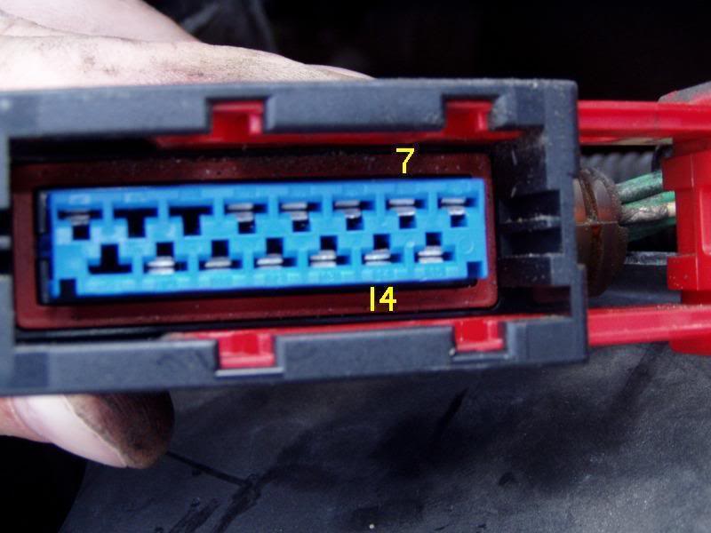

The relays pull out towards the front.
Rotation is free play in the sockets.
If both fans always do the same thing together, then there is no fault in the relays.
Speed control faults are caused only by the Bitron; the sensor; and the plugs, sockets and wires from the sensor to the Bitron.
Pins 7 and 14 go to the sensor.

Hi Clogzz. I did check resistance between the bitron "plug" and the sensor- but just the wires from the sensor plug and the relevant pins in the bitron plug. Though was using an old guide based on a 306 so will double check that it was pins 7 & 14. When I checked a few weeks ago, they seemed fine with little or no resistance in the wiring but I din't check the sensor resistance at the plug. Will check again this weekend. Whats interesting now is that the fans ALWAYS come on at cold start either while the glowplugs are starting up or immediately after the engine starts. Run for about 2 minutes full tilt then shut off. Annoying as hell. Rarely now run on warm starts, but do activate when the engine hits over 90 degrees as normal. Even wondering it its a voltage drop thing......
Thanks
Thanks
Clogzz
- Posts: 2125
- Joined: 15 May 2005, 18:04
- x 40
Re: HELP!! Xantia Cooling Fans Driving me nuts!!
Hi Alan,
Probably no voltage drop because there’s enough to start the engine and run the fans at high speed.
The measurement between pins 7 and 14 with cold engine is about 1900 Ohms.
When hot it’s well over 3000 Ohms.
Best wishes and keep fiddling.
