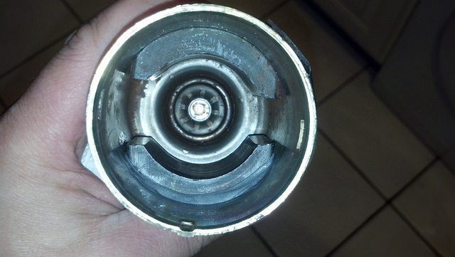

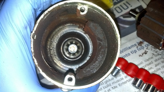

Update time! Bought some metal epoxy to stick the magnet back where it belongs. http://www.unibond.co.uk/en/diy-adhesiv ... metal.html" onclick="window.open(this.href);return false;
Cleaned the back of the magnet and keyed it up. Ditto the casing which was a bit surface rusty. Whilst the old adhesive was white, I couldn't see any around the other magnet, perhaps someone got there before me with a repair? Either way, I elected to plonk the magnet back where I found it, which was slightly off centre.
IMG_20150514_220555_327 by macplaxton, on Flickr
IMG_20150514_220625_965 by macplaxton, on Flickr
Still a bit lame, but they work without a racket now. I suspect the magnets could do with re-magnetizing. Being a closed-ended bucket I've no idea how you get a keeper ring in there.
Anyway, here's the vid. (c. 20 sec is speed 1, c. 30 sec is speed 2)
If you have a GS or GSA with quicker wipers, video it and show me what I'm missing!
Cheers.
Cheers.

are the wheel box's (spindle housing's ) nice and free/smooth in there movement, maybe they are binding/tighter than they should be,
although i see in one of your picy's you have the cast alloy spindle housing's, they can still bind/cause drag even though they have a bronze bush through them,
otherwise maybe you dont have the same clearance between the armature and the re/glued magnet as the other, as i believe the clearance has to be equal

Rich,
I think the motor will have overheated because of the spindles seizing - this is a very common fault on the 2CV/Dyane/Ami and eventually will either cook the armature windings or damage the plastic insulators on the three contacts.
Hope you'll sort it by reattaching the stator magnet; might be worth a look at the other one to see if it ought to be re-glued.

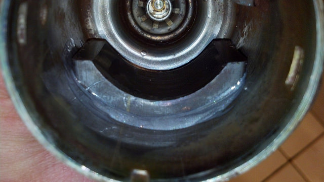

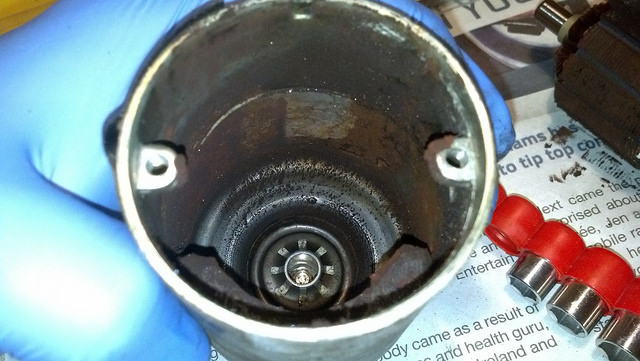

Malc/Mike.
citronut wrote:are the wheel box's (spindle housing's ) nice and free/smooth in there movement
Free as a bird. When disconnected from the motor the whole linkage is dead easy to move manually. No sign of seizing.uhn113x wrote:I think the motor will have overheated because of the spindles seizing
citronut wrote:otherwise maybe you dont have the same clearance between the armature and the re/glued magnet as the other, as i believe the clearance has to be equal
Well they work well enough (was raining today driving back from work), just being fussy really. My suspicions from the visible white epoxy on the loose weight was that it may have been messed with before. The other one doesn't have any visible glue peeking out and seems firmly attached. I maybe should of set the loose magnet dead opposite the non-loose one, but I elected on the day to just go by the lining up with white goo marks on the body and magnet and scribing a line and leaving it as I found it.uhn113x wrote:might be worth a look at the other one to see if it ought to be re-glued.
Having said that, the loose magnet does have some scuffing from the armature on the inside face, so there is a bit more clearance between the magnet and armature at that point in the cycle. The main thing is I can see where I'm going!macplaxton wrote:
