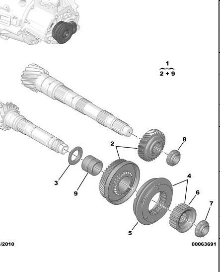

The nut is available from Citroen - but if it's just come loose, then I would just put some threadlock on it, tighten it up and re-stake it. If the synchro is damaged, then it may be possible to turn it over - I did a search and this seems to be a common problem on motorhomes fitted with this box - and in those cases, the gear is usually broken. You can buy a new gear set from Citroen, but it's not cheap....
Part Number Description Quantity Price excl. VAT Price incl. VAT Total incl. VAT Selection
00002344F5 PINION ASSEMBLY 141.91 GBP 170.29 GBP 170.29 GBP
0000230459 SHAFT FIX NUT 1.77 GBP 2.12 GBP 2.12 GBP
0000230481 SHAFT FIX NUT 3.19 GBP 3.83 GBP 3.83 GBP
0000232119 SYNCHRO HUB 21.12 GBP 25.34 GBP 25.34 GBP
0000233933 GEAR SPACER 4.16 GBP 4.99 GBP 4.99 GBP
0000238832 SYNCHRONIZER 119.67 GBP 143.60 GBP 143.60 GBP
Total excl. VAT 291.82 GBP
Total incl. VAT 350.17 GBP
Depending on which parts are broken of course....! Looks like you can get the parts for about 1/2 that on ebay - eg This one - not necessarily the exact kit, but the vendor sounds like they will be able to find the right one!

The easiest option does seem to be get a gearbox and replace the gears and synchro stuff. Are these just held on by that locking nut and thats it? I notice two locking nuts were mentioned, so I assume one tightens it up and the other acts as a safeguard locking nut? Anyone know compared to a gearbox change timewise?
Could I safaly assume about two hours to access the back plate and remove the stuff and replace or is that too easy? I would assume thats easier than dropping the gearbox but do not know what room there is at the back of the gearbox to facilitate this?
- Posts: 12576
- x 1485
Re: Car jumping out of 5th gear and now unable to select it
2 shafts hence 2 nuts:
There's a selector fork in there somewhere as well that will need to be removed probably to get the gears off.
It should be possible to remove the end cover in place - worse case scenario is that there is not enough room under the chassis rail, and the box mount has to be undone and dropped slightly. This should be significantly quicker than replacing the whole box. Hopefully, you will find that the nut on the shaft is loose allowing the synchro unit to float about, and that all that is required is to tighten it up.
